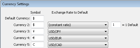

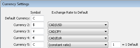

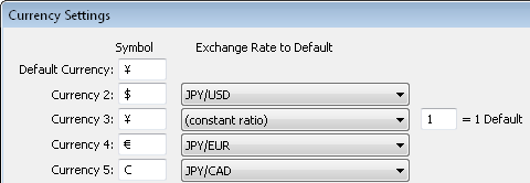

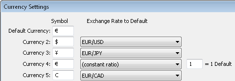

Currency templates remember a complete particular set of currency settings. Currency templates can be used to quickly switch your currency settings between commonly used configurations. Currency templates can be useful for displaying all your investments adjusted into various default currencies. To use currency templates, assign all your investments to currencies in the "Currency 2" to "Currency 25" range, and do not use the "Default Currency" for the property of any of your investments. Define different currency templates where you leave the currency symbol for Currency 2 to 25 un-changed, and change the default currency as well as the exchange rate rules to that default currency. For example:
     Template Name  |
    Currency Settings |
     USD Default  |
     JPY Default  |
     EUR Default  |
     CAD Default  |
Notice how in the above examples, the currency symbols for Currency 2 - 5 were not changed. Only the default currency symbol and the exchange rate to default rules were changed.
