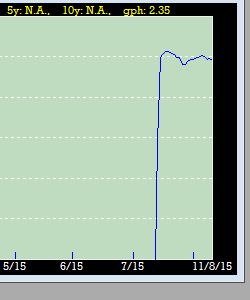

No matter how much I look into it I cannot make the portfolio value graph to start back on the date the portfolio started (jan 2104) . Result is a useless spike in the value which starts sometime between July and now [see attachment] .. and renders the whole graph useless.. Please advise . Many thanks Costas
FM Capture.PNG (3.48 KiB) Viewed 1292 times

Hi Costas,
I couldn't see the whole graph, but it looks like the issue is your Y axis scale. If the X axis date range is okay, but you're not seeing the line before 7/15 it is because it is below the minimum of your Y axis. You can adjust the Y axis using "View / Scale...". You can either specify the min/max, or turn on autoscale. For a keyboard shortcut that sets your graph X and Y axis to full scale, use "Shift + R".
