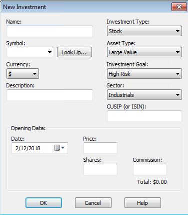

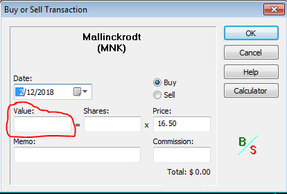

I have FM 2014. The New Investment dialog does not have a value field like the Buy/Sell dialog. This continually creates a problem for me when entering intial purchases that do not have an integral price per share value (i.e, price per share * num shares = value with fractional cents). In this case I have to make up a share price to create the investment and then go edit it to fix up the correct value (which then usually results in an irrational share price, but who cares - it is what it is).
Is there a way to enable the value field on the New Investment dialog so that the correct value can be entered there?

Sorry, there isn't an option to add value onto the New Investment dialog. You have a couple options:
1) Just leave the shares blank, or set to 0. Set the price to a closing price for the date, or just set it to 1, and overwrite that price later by doing a price retrieve. After you create the investment, use the Buy/Sell dialog.
2) Calculate the price/share and enter them into the New Investment dialog. Just take the value, and divide it by the shares, and enter this into the Price box, to as many decimals as necessary.
