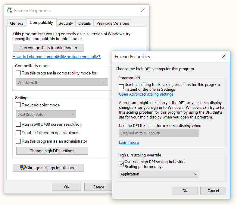

I may have found the issue. If you go into your Windows 10 "Settings" and under "Display" for "Scale and Layout" change the scale to 100%, please see if that fixes the issue. You may have to sign out and back into Windows to make the changes take full effect. We'll have to see about fixing this for the future, but for now I believe if you make the scale 100% that should correct it.
If you don't want to change the global scale setting (which will apply to all programs), you can set the scaling for only Fund Manager. Go to the "Properties..." of the main FM.exe file and under the "Compatibility" tab, select "Change high DPI settings" and then turn on "Override high DPI scaling behavior" and set it to "Application". It should look like this:
Override high DPI scaling for FM only
Postby ASU » Tue Jan 22, 2019 6:03 pm
This worked!!!
