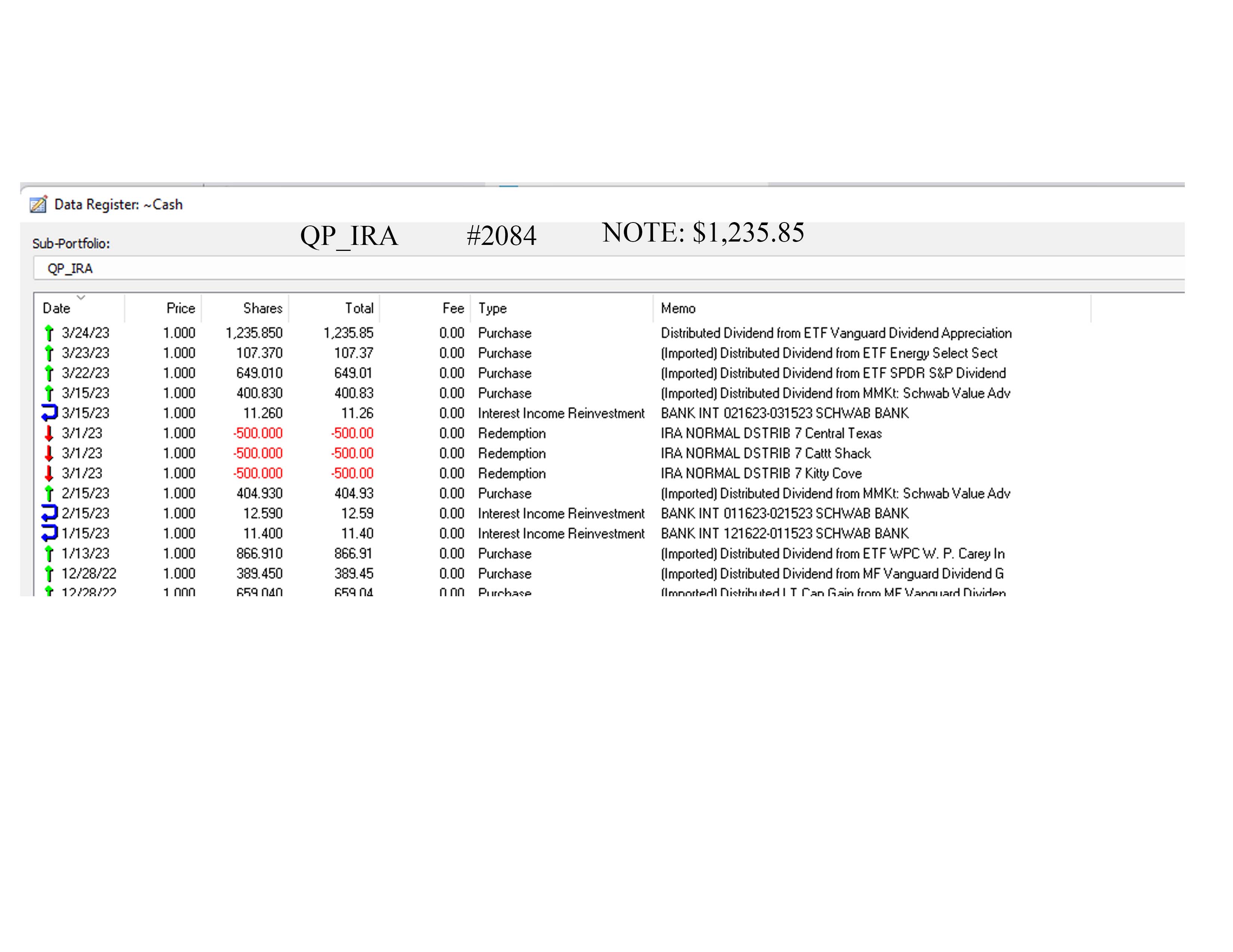

Over the past year I have experienced several instances of dividend transactions being downloaded to FM: (1) dividend as cash and (2) dividend as reinvestments.
All investments at Schwab are marked as NO (don't reinvest); in other words just send me the cash.
Yesterday a Vanguard ETF (VIG) paid a dividend of $1,235.85. The download transaction shows that amount as both a distributed dividend and a retrieved dividend. Since FM processed both transaction, the FM total exceeds Schwab's total by $1,235.85.
Hope you can help. We are heavily invested in dividend achievers, so almost every week when I reconcile FM with Schwab, I have a major headache to get the mess cleaned up.
You have been so effective in resolving this kind of transaction download problem, hope you can work your magic again.
Sincerely, Good_Vibe

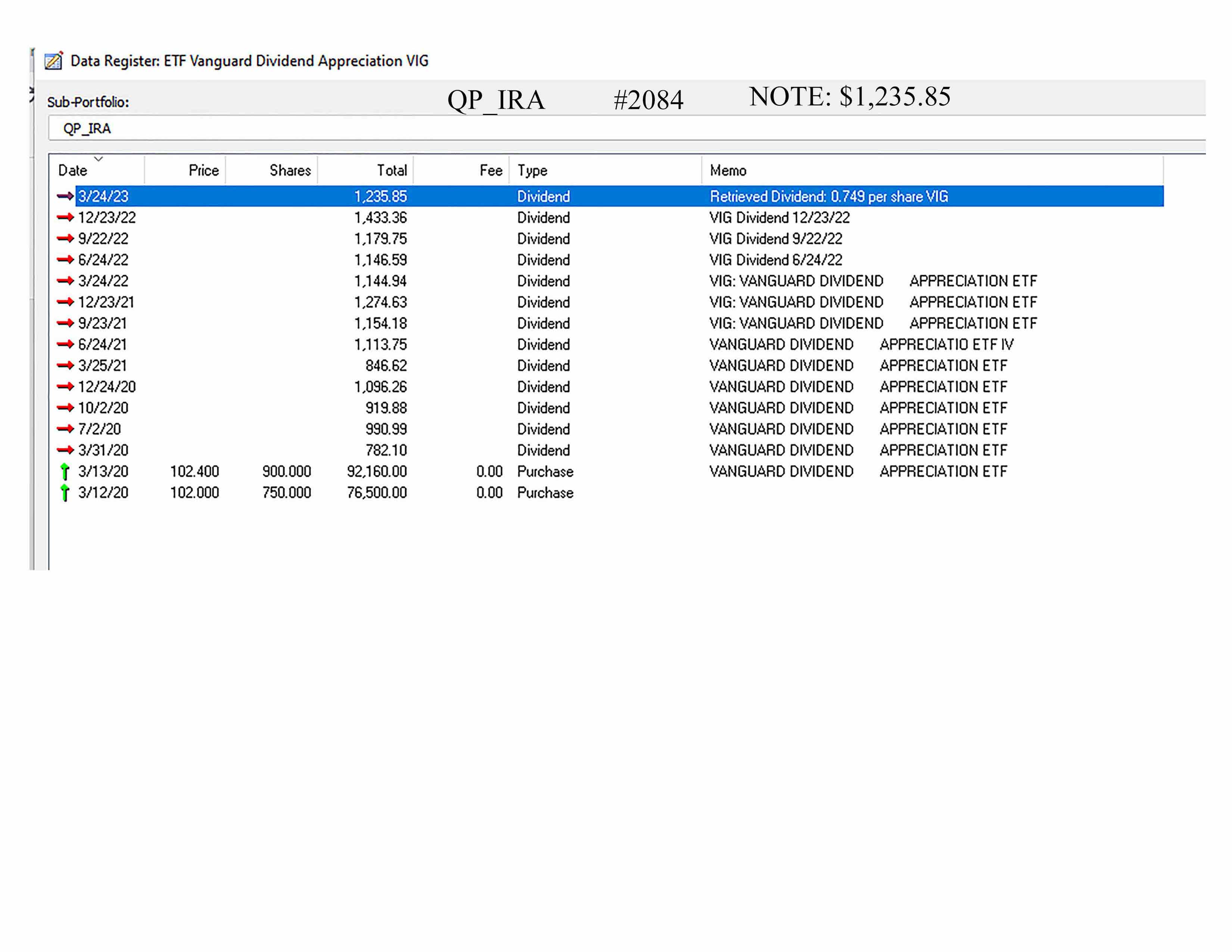

QP_IRA Vig II.jpg (199.21 KiB) Viewed 7442 times
QP_IRA Cash.jpg (228.49 KiB) Viewed 7444 times

I just see 1 distributed dividend in a a fund, and 1 purchase into a cash investment. That seems correct. Did you already fix it before making those screenshots?
Based on the memo for the distribution that says "Retrieved Dividend: 0.749 per share VIG" that appears to have been retrieved through Yahoo (Historical) instead of from Schwab. In the Pro/Adv versions when you use "Yahoo (Historical)" to retrieve prices, there is also an option to retrieve splits and distributions. If you're retrieving transactions from your broker, you don't want to also retrieve splits/distributions from Yahoo, as you will double count them. To prevent this, just un-check those options when retrieving using Yahoo (Historical).

Yes, it sounds like you should delete both the distribution in the fund, and the cash deposit, and wait for it to come down through Schwab.
The "memo" field is different for distributions retrieved through Yahoo versus your broker, so that is how I can tell it was from Yahoo (Historical).
