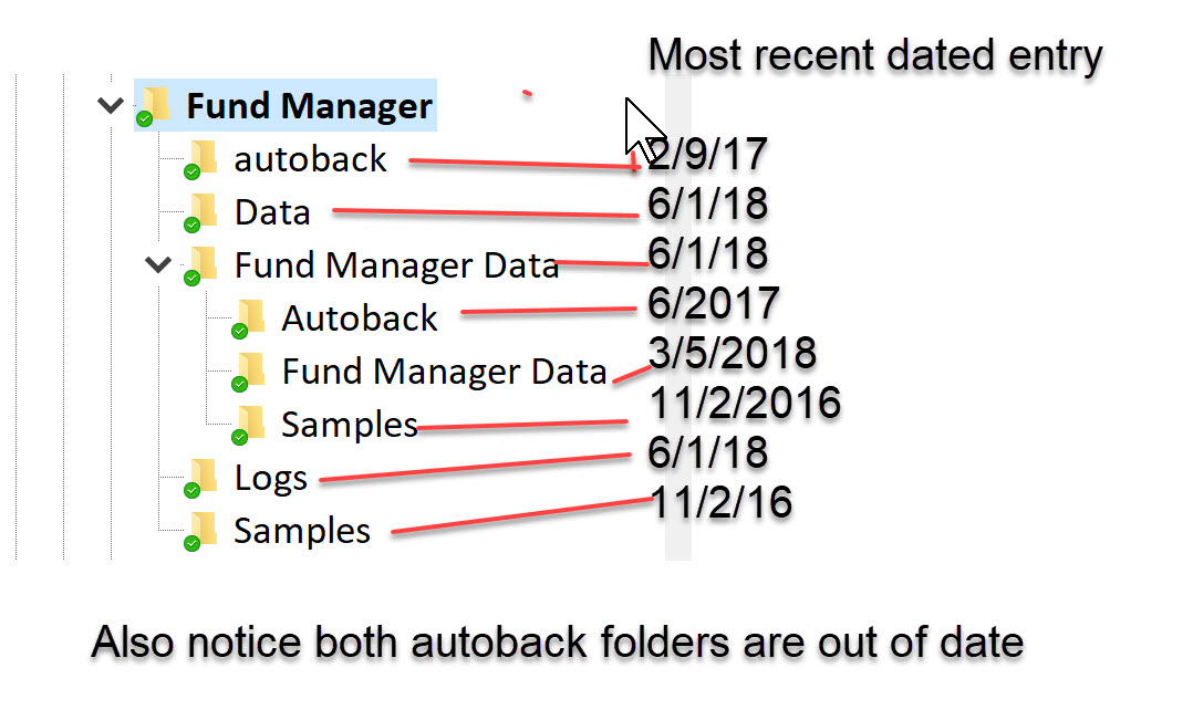

I have been using FM for a million years. I have upgraded every time there is an upgrade. I have also changed computers multiple times. I now have a mess. I have redundant FM folders within other FM folders (see attached),
Plus, inside virtually EVERY folder, including the top-level folder, there are files representing specific individual purchases or sales of specific stocks or funds.
Plus, over the years I have made repeat purchase of the same funds. So I could have purchased a specific fund 5 years ago, sold it 3 years ago, then bought it again last month. Lots of entries.
So now FM is getting funky. It doesn't know I sold something or bought something, and when I reconcile, it doesn't notice that there is a disagreement with the broker's records.
I'd like to clean this all up but am not sure how to do it. Can I move all of these transactions into a single folder? If so, which one is the INTENDED place to store discrete events?
PS, as a side frustration, I also can't alphabetize holdings when I create a report, so that it is very hard to reconcile with the broker's records, and I can't figure out how to fix that either.
Marys FM Folders .jpg (137.14 KiB) Viewed 2696 times

Hi Mary Kennedy,
The default location for your data files (not the program itself) is "My Documents \ Fund Manager". You can have Fund Manager help you by doing a "File / File Operations / Set Data Location..." and choosing this folder. Any currently open data files not located here will be copied to this folder. You would need to repeat this for each *.mm4 file you are using. Usually you only have one *.mm4 portfolio file, so you would only need to do this once to get all your data files into a single folder. After this, you could delete all your other data folders. I'd suggest maybe moving them somewhere different for a while first, just to make sure you don't need them. After using FM for a while without issue, you can then safely delete them. If you already have a bunch of unused data files in your "My Documents \ Fund Manager" folder, you could create a new/empty folder and have FM copy all your data files into this folder instead. For example "My Documents \ Fund Manager New".
You would want to keep your one autoback folder, directly beneath "My Documents \ Fund Manager", as that is the default location for your automatic backups. Verify this under "Options / General Preferences... / Data".
The above will get all your *.dat files into a single folder. However, if you've created multiple *.dat files for the same security, and have transactions spread among multiple investments that should have been in a single investment file, this will not fix that. You can merge multiple investment files that belong together into a single investment file by following this tutorial on merging investments.
When you create a report that lists by investment, the default sort order is "Investment Stack". You can sort the investment stack by name, by using "Investments / Sort By / Name". This is probably better, but you could also just force the report to sort by name using "Sort / Investment". Sorting the stack though will have the benefit that future reports will automatically be sorted by name. Save your portfolio after sorting the stack by using "File / Save Portfolio".

OK, small detail I forgot to mention. I am trying to run this on a cloud drive so I can access it from multiple devices. There is a "documents" folder up there but FM is not under that right now. Would that be my first step, then, to move my FM files into the cloud-based "My Documents" folder, then follow the rest of your ideas?

Postby Mark » Fri Jun 01, 2018 10:00 am
You can use the Set Data Location... command to move them anywhere you want, local/cloud/etc it doesn't matter, as long as you have write permission to the location.
