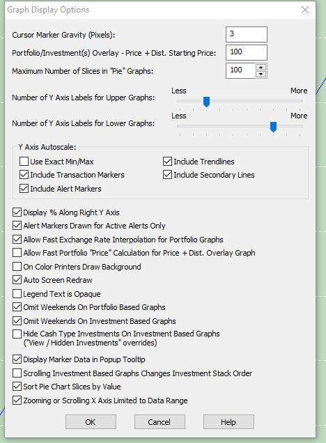

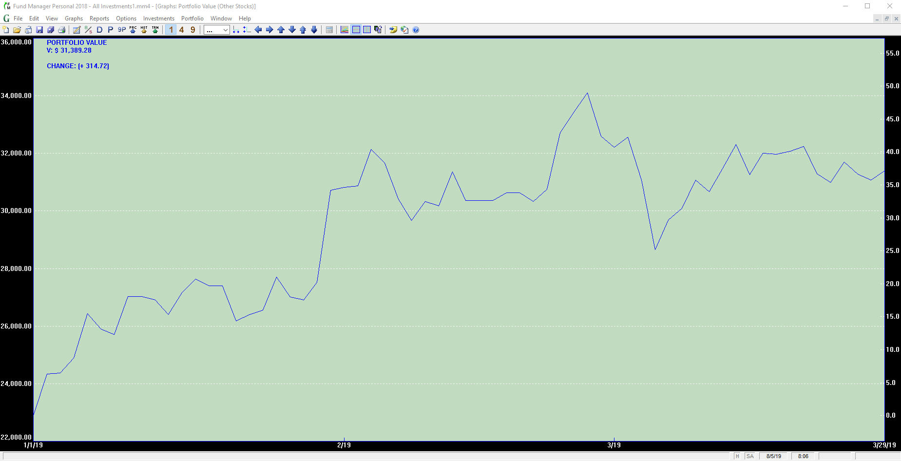

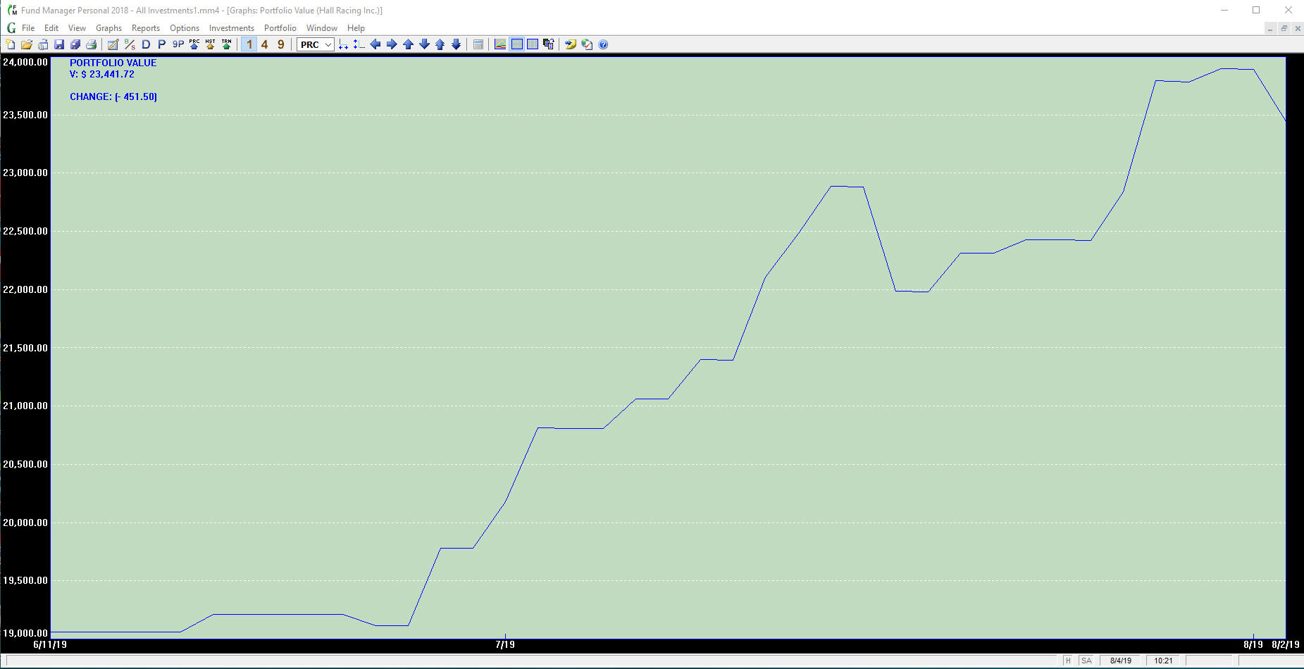

Postby Glenn Hall » Mon Aug 05, 2019 7:05 am
FM 2018_Good Page .jpg (147.19 KiB) Viewed 2265 times
FM 2018_Prob Pg_Grph Disp Options.jpg (77.1 KiB) Viewed 2265 times
FM 2018_Prob Pg .jpg (150.54 KiB) Viewed 2265 times
In pulling up the display options of both graphs, they appear to be the same Option list.
#1 I downloaded the 2018 FM and installed
#2 Removed a sub folder
#3 Created a new folder (which is the problem one)
#4 Downloaded stock information
#5 Problem
#6 I have downloaded and re-installed FM 2018
#7 I have changed some of settings in the Option List to see if that corrected problem
#8 Changed Options back to settings that problem graph started in
Hopefully this info will help solve the problem
Glenn

Postby Mark » Mon Aug 05, 2019 10:01 am
Hi Glenn,
The problem is that you're plotting since the first transaction date. This means, the beginning portfolio value for the % calculation is $0, thus percentages can't be displayed. Here is the documentation on this feature to label the right side with %:
Label the right Y axis with percentage change since the beginning of the graph. Available in graph types where it makes sense to label with a percentage. The baseline (0%) reference is the value that would be plotted on the day prior to the starting graph date, such that the %'s are inclusive of the starting graph date.
So, to fix this, just change the starting graph date to 1 or more days later.
