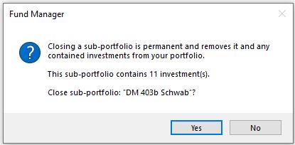

Postby sbfree » Wed Jan 15, 2020 5:39 am
Hi Mark:
Thanks for the reply. I have attached a screen shot of the warning window which opens after choosing to close a portfolio. I try to close the portfolio by highlighting it, then right click to get to 'close' from the menu. There are no other prompts or windows that I can see once I select 'Yes' from the warning window and the program hangs. I thought I was using the program in a portable mode and have a launcher that directs to : "R:\Dropbox\FundManager\FM-Install\Fund Manager\Fm.exe". On normal closing, there is always a period when W10 warns that the program is unresponsive but that resolves in 5-10 seconds. I have never tried to remove a portfolio before. Removing one that is empty works without a problem. I have tried pausing syncing of Dropbox before using the program and it doesn't resolve the problem. I no longer use the program and data from any other machines other than my W10 install. There was a time when I would access the program and data from other machines that ran Linux using WINE. I am not opposed to trying to resolve this by creating a more conventional installation but would ask for some guidance on not loosing my data or configuration.
Scott

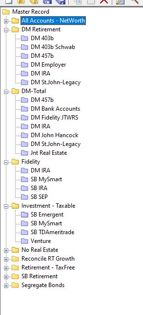

Postby sbfree » Mon Jan 20, 2020 4:02 pm
Hi Mark:
Does the attached screen explain how I am using linked portfolios? The All Accounts are linked to the web as much as possible, any portfolio at that level is filled only with linked accounts. Maybe I've used your software in a way you didn't intend. If I can explain more, please let me know.
scott
