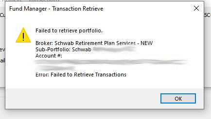

Postby thrombus » Tue Oct 19, 2021 6:54 pm
Nothing useful, just failed to retrieve (see attached).

Both Charles Schwab - NEW and Schwab Retirement Plan Services - NEW are the same. If you only use Charles Schwab - NEW with all of your accounts, and with the same access code, does that work? If not, can you please email me your log file from "Help / Logs / Transaction Retrieve (Raw)..." right after retrieving only 1 of these problematic accounts?
