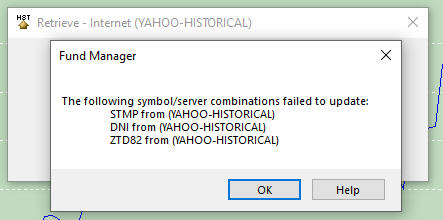

I am doing a Yahoo Historical Retrieve on all investments and have been given a notice multiple times that there is a failure to update the following: STMP, DNI, ZTD82.
In Fund Manager I go to 'Ctrl o" which takes me to backup files. I find 4 STMP files, 7 DNI files, and 3 ZTD82 Files.
How can I find out which files the message from Yahoo is referring to and clear them?
Screen display from Yahoo
Fund Manager .jpg (21.56 KiB) Viewed 1073 times

Hi Glenn Hall,
Don't look at the files on your hard drive, look at the investments in Fund Manager. One easy way to find these is to look at "Help / Logs / Price Retrieve...". You will see a listing of all the failed attempts to retrieve, along with the full portfolio hierarchy of where each investment is located. For specific help on how to correct this, see this FAQ:
https://www.fundmanagersoftware.com/faq_bad_symbol.php
