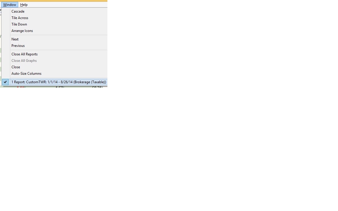

Postby Mark » Thu Aug 28, 2014 11:24 am
If you look under the top level "Window" menu, do you only see a single Report window listed? I'm wondering if you have another report window open, but maybe not in the foreground?
Posts: 11849
Postby flight » Thu Aug 28, 2014 11:29 am
I had the Portfolio Editor open, but even when I close, doesn't seem to help.
flight
Posts: 151
Joined: Sun Jul 27, 2014 11:03 am
Postby Mark » Thu Aug 28, 2014 11:39 am
The Portfolio Editor won't impact your report column widths. Look at the bottom of the "Window" menu. What open windows do you have? You may have multiple windows open, but only viewing one.
Posts: 11849
Postby flight » Thu Aug 28, 2014 11:45 am
i think i only have one window open
flight
Posts: 151
Postby Mark » Thu Aug 28, 2014 11:57 am
Yes, you are right, you only have 1 window open. Okay, please either call our office at 480-705-0129 so we can connect in, and take a look at this, or email us a backup of your data. To do this, use "File / Backup..." and email us this *.FMB file as an attachment, so we can test it with your data/settings to see why the columns aren't auto-sizing correctly.

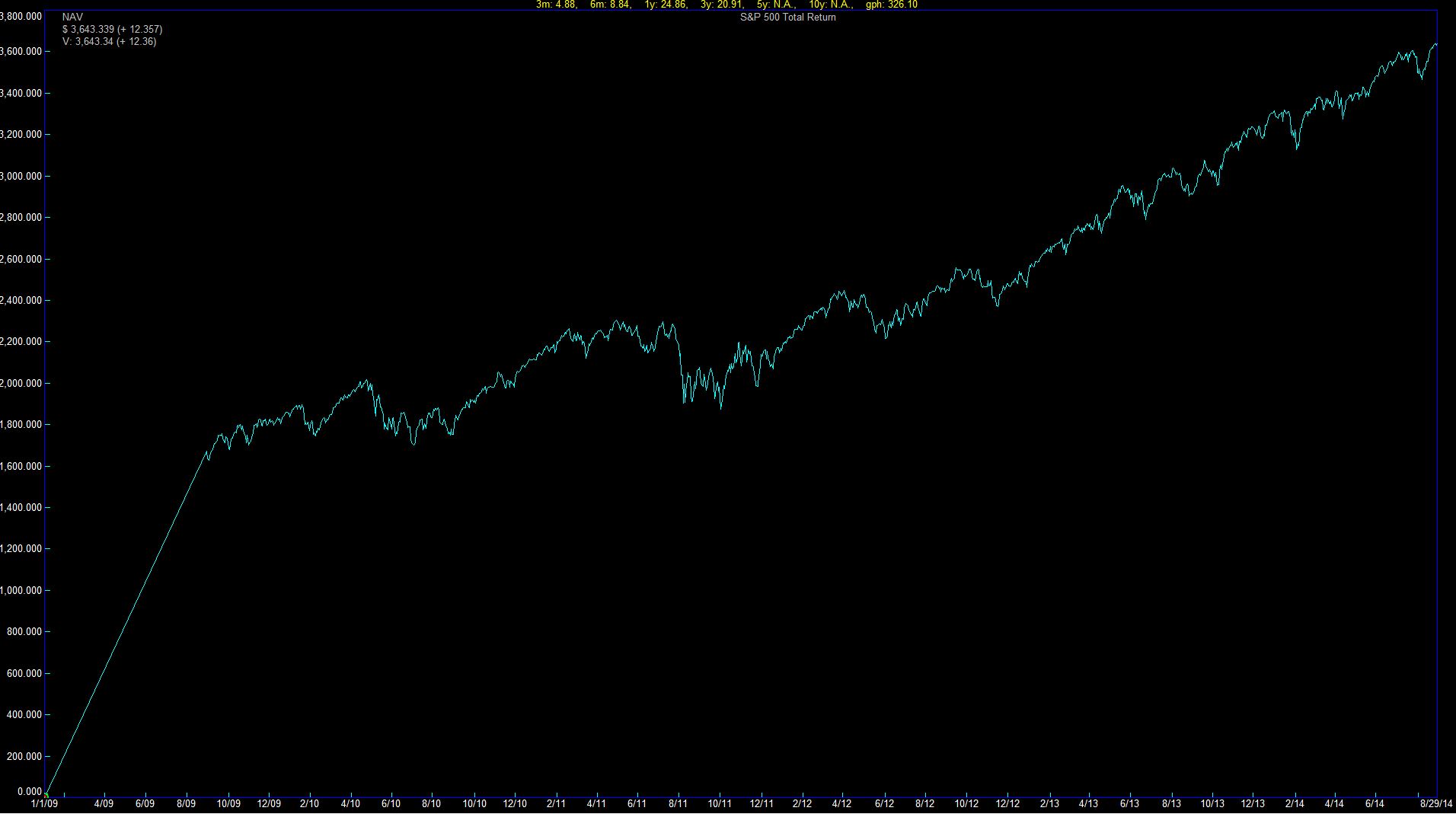

On the SPTR:IND, I tried to retrieve historical bloomberg prices starting 1/1/09, but the first 8 months of 2009 do not appear. See this graph. You can also see the 5-yr comes up as N/A.
Does this seem correct?
Note, I book an initial entry on 1/1/09 of 1 share for $1
flight
Posts: 151
Postby Mark » Tue Sep 02, 2014 8:07 am
Hi flight,
It looks like they only have pricing for about the last 5 years, so it isn't going back all the way to 1/1/09. If you're only looking at TWR it isn't necessary to record a buy transaction, and if you do want to record a fake buy, it is probably better to do it at the market price than at a price of $1.
