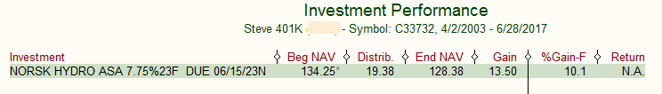

I was forced to transfer some securities from one account to another. This has to be reflected in FM of course so the price/transaction retrieval works properly but the transfer has no tax or investment significance. Therefore I'm interested in the transfer having as little impact on the performance/capital gains reporting as possible. I used the original OOP and date purchased number on the Transfer In side and have the "Transfer Transactions OOP Calculations Use" setting to "Original OOP". Further the two accounts in question are sub portfolios in a single main portfolio (All Assets). I would like to be able to look at Investment Performance of a transferred security in the main portfolio and have the performance/capital gains calculated as if no transfer occurred. What seems to happen is that the Investment Performance report on the All Assets portfolio picks up only the account transferred into seems to show up despite the date range encompassing the entire investment period. What the best way of accomplishing what I'm trying to do?

Your "All Assets" report is starting in 2012, but the "401K" report is starting in 2003. Is that the confusion?
You can either record the "Transfer In" and "Transfer Out" transactions yourself, or you can use the "Transfer Between" wizard, which will do this for you. This wizard will also record multiple transfer in transactions if there were multiple lots.
Another option for you is to simple move the investments from the old to the new sub-portfolio, and not record any transactions. You could put a note in them if you wanted. This moves the whole investment, and all the history.
