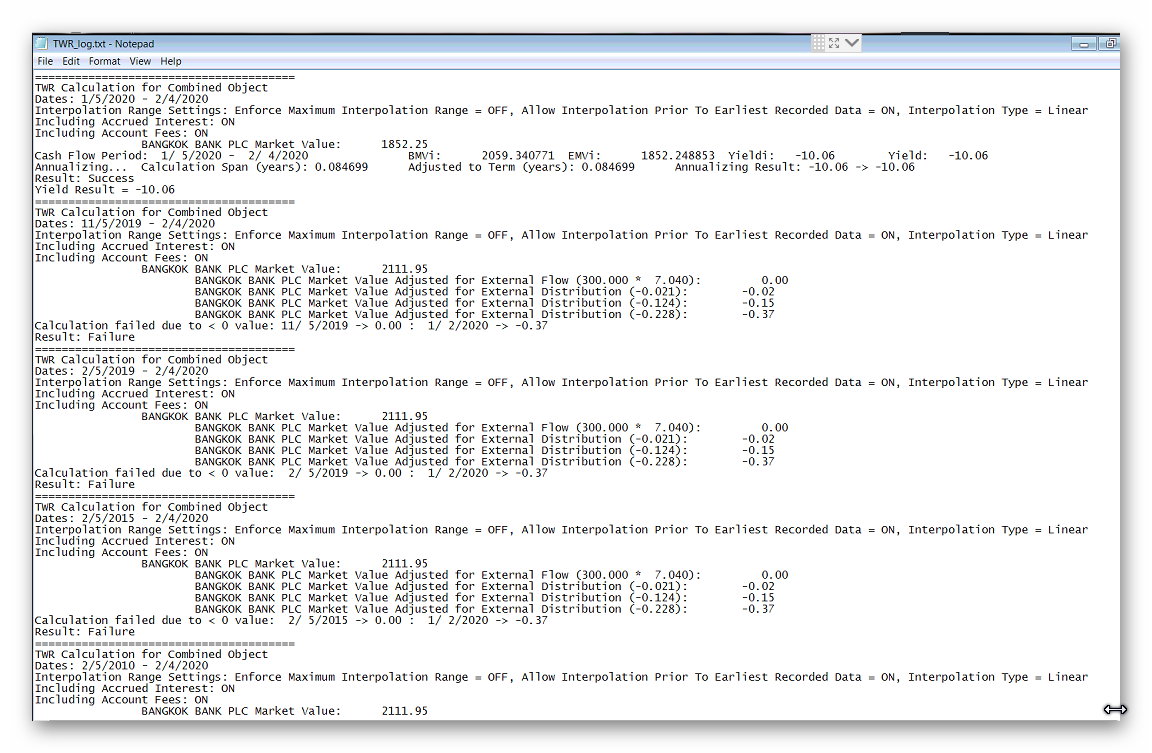

TWR log & data screen
twj332

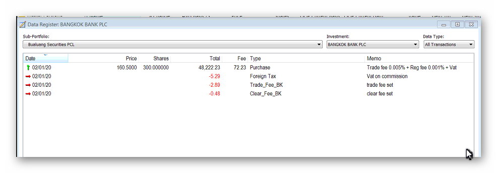

transaction screen
attached is transaction screen

Hi twj332,
The reason is that after adjusting for all the cash flows, the value becomes negative. TWR and ROI cannot be calculated on negative valued items. There are a couple options you have:
1) Include these fees that you have as negative valued distributions into the "Commission Fee" field. This is simple, but the downside is you can't report on the breakdown the way you can if you record them as negative distributions. See option 2...
2) Record these negative valued fees for a day after you purchase the original shares.
Postby twj332 » Wed Feb 05, 2020 6:15 pm
Adjusted the (nef) distribution amt. to one day after and the owned on date to the date of purchase and the calculations worked.
Thanks Mark
