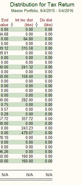

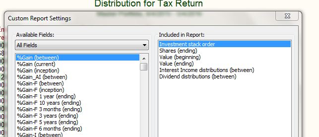

Postby hedgie » Tue Dec 13, 2016 2:16 am
It's a Custom report with all currencies in UK£
two screen grabs attached which may help/???
Comumn totals for End Value, Int Inc and Div Dist show N/A instead of Sum
tax return2.JPG (45.71 KiB) Viewed 3068 times
tax return.JPG (42.96 KiB) Viewed 3068 times

Postby Mark » Tue Dec 13, 2016 7:56 am
Hi PeterG,
Did you try turning on "View / Exchange Rate Adjusted"? If so, and that still does not help, make sure any "exchange rate" type investments and any investments assigned as exchange rates under "Options / Currency Settings..." are assigned to the top-most/default currency. See "Investment Properties...". Please see:
https://www.fundmanagersoftware.com/faq ... encies.php
It looks like somehow not all of your investments are in the same currency. You can also test this out by temporarily turning on:
Options / General Preferences... / Other / Allow Summing Values from Different Currencies

Postby Mark » Sat Dec 17, 2016 7:32 am
Hi PeterG,
It sounds like somehow one or more of your investments are assigned to different currency positions.
- Make sure under "Options / Currency Settings..." you only have UK£ specified once.
- Turn on "View / Hidden Investments/Portfolios" and run a Custom report with the field "Currency". Sort the report by this, and at the top or bottom you should find at least one investment with a different currency.
