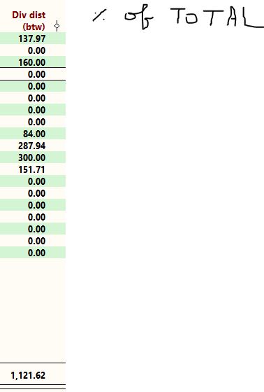

Is there a way to get a percentage of the current row with the report total of a specific field
For instance in the following image, is there way to create a custom field to show the % of the total with respective to their each item. The goal here is to see how much percentage of the total income is a specific line item. As always thanks in advance for your answer.

Hi divinvest,
Yes, use the functions:
REPORT_PORTFOLIO()
REPORT_SUBTOTAL()
For example, you can write this equation:
100*Divdist_btw/REPORT_PORTFOLIO(Divdist_btw)
to get what you're describing.

Postby divinest » Sat Feb 17, 2018 4:22 pm
Thanks very Much Mark, that worked.
