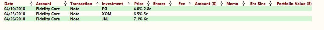

Postby divinest » Sun Apr 29, 2018 4:10 pm
Thanks Mark, i ran a report as suggested, however see the attached, is there a way to show only the date/symbol/notes as header? Thanks!
Investment Report
divinest
Posts: 149
Postby Mark » Sun Apr 29, 2018 4:23 pm
Hi divinest,
You can get it with: Date / Transaction / Investment / Note
In the "Preferences..." dialog turn off the option to display the account number, and un-check all the display columns except "Price", which is where the notes are displayed.

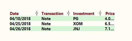

Postby divinest » Sun Apr 29, 2018 4:29 pm
Thanks Mark, that worked, however please see the attached, the price now show with ... (3 dots), i tried auto size col as well. (workaround: if i add the memo field then the price displays full info)
col info
divinest
Posts: 149
Postby Mark » Sun Apr 29, 2018 4:31 pm
The last column has a hidden divider, so you can widen the column. Click/drag where you would imagine that divider would be, based on the other column dividers.
Postby divinest » Sun Apr 29, 2018 4:33 pm
Cool, that worked, thanks for the info (nice to know there is a hidden col separator)
