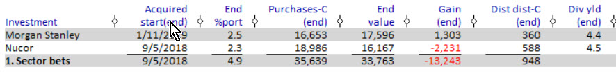

Hi Mark. I have been noodling all the different versions of OOP cost and have a couple of questions.
(a) I want to create a chart that has (a) original expenditure, (b) current value, and (c) dividends. Most estimates of (a) subtract out all dividends. So if I paid $1000, my column would not list $1000, it would list 1000 minus all interim dividends. I want to separate the gain from the dividends in my chart. I finally resorted to "Purchases-C" instead of any of the OOP measures, but am not sure this is right either.
(b) I am attaching a portion of my draft report here in the hope that you can explain the "Gain" column, in particular the total gain for the section, which in no way summarizes the two numbers in that column.
Any comments/thoughts you have will be appreciated

Postby Mary Kennedy » Fri Jun 28, 2019 8:10 am
I'm sorry, I had two unrelated questions and shouldn't have put them into the same query. One had to do with how fields are defined and you have clarified that. The other had to do with the attached image. It shows a group of just two holdings, and in the "gains" column there is a sum that appears to have no relationship to the numbers above it. That sum is what I am still befuddled about

Postby Mark » Fri Jun 28, 2019 9:12 am
Hi Mary Kennedy,
You are using the "Gain (inception)" field, which is the gain since the very first transaction. In your portfolio line, that is the first transaction in any investment in that portfolio, including any hidden investments. Try turning on "View / Hidden Investments/Portfolios" and see if that doesn't clarify things. I'm guessing you have some sold investments that are hidden, and not being displayed, but they have a historical gain/loss since you are asking for the gain since inception. Instead, if you change this to "Gain (current)" you will likely see what you're expecting.

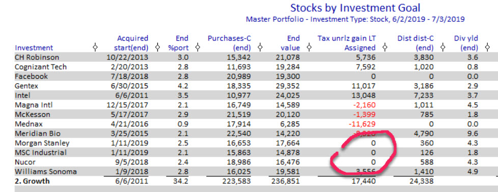

Postby Mary Kennedy » Wed Jul 03, 2019 6:26 am
Thank you a ton! My "before" and "after" columns finally look right. However some of the "gain" columns, via the Tax unrealized gain variable, show zero for unrealized gain, even though the first two columns imply a gain or loss.

Postby Mary Kennedy » Wed Jul 03, 2019 7:25 am
here tis

Postby Mark » Wed Jul 03, 2019 7:38 am
Hi Mary Kennedy,
You are displaying:
Purchases out of pocket (current)
Value (ending)
Tax basis unrealized gain LT, Assigned Method
If instead, you display:
Tax basis, Assigned Method
Value (ending)
Tax basis unrealized gain, Assigned Method
you will see consistency. Notice, the first field is an OOP number, and your gain is a Tax number. Also, you have the "LT" version of the unrealized gain, which only shows the "Long Term" portion of your gain. The one I list above shows the total gain, for all terms combined.
