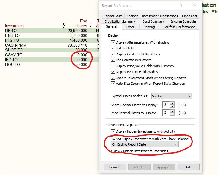

If I'm getting this right, in my Custom report, the last (3) stocks on the attached should not display. However these (3) had activity so it looks like the behaviour is the same for both option selected.
Michel
Capture Hide zero balance.jpg (91.99 KiB) Viewed 3510 times

If those investments had any activity within the date range of your report, they will be shown, since you have on the option to display hidden investments with activity. I think what may be confusing is that you also have on the option to not display investments with zero shares, which is also true here. However, that second option makes any investment with zero shares as if it were marked with the hidden attribute. The first option overrides the hidden attribute, and will cause any item with activity to be displayed. If you press the "Help..." button in that dialog, it is explained a bit more in the online help. It sounds like you may already know about hiding investments, but we have a tutorial on how to hide investments you might find helpful.

That was the problem. Thanks. Now I see the priority order of these options.

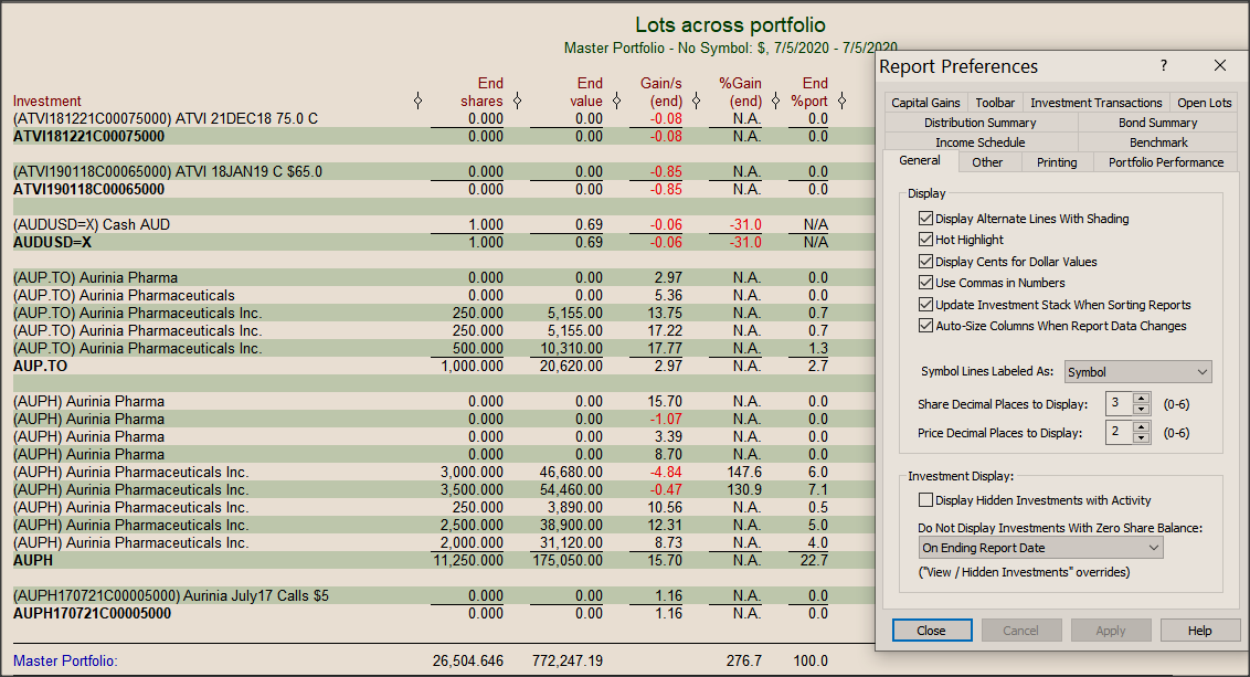

I seem to be having the same issue but I don't have hidden checked:

Check 2 things:
1) Is "View / Hidden Investments/Portfolios" un-checked?
2) Turn up the share display, and make sure you own 0.000000 (out to 6 places after the decimal point) shares.
Posts: 11576
Postby danmcco » Wed Jul 08, 2020 11:21 am
Thanks Mark. View...Hidden was checked when I ran the report even though unchecked in report settings. Unchecking fixed it.
