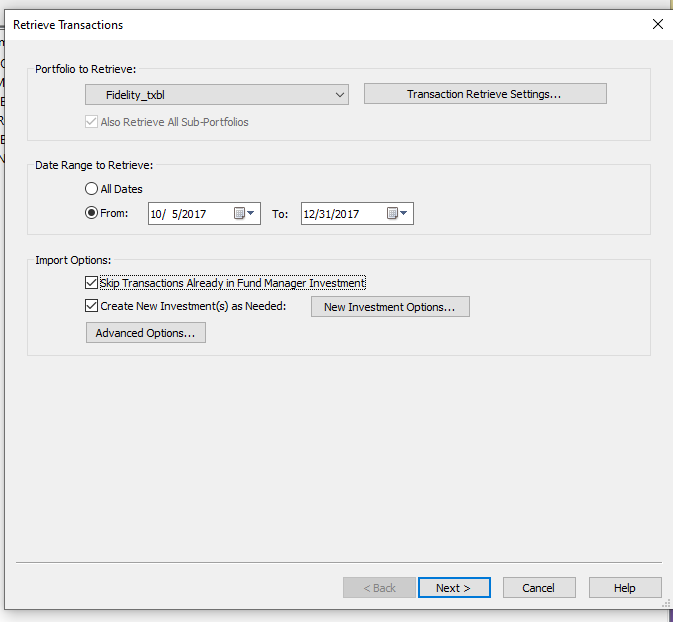

But I nonetheless tried a test to retrieve transactions from one Fidelity account from final 88 days of 2017, using the TRN button to kick off the process. This account existed throughout that entire date range, and already is present within Fund Manager. I verified both dividends received and stock sales occurred during that time period within that account.

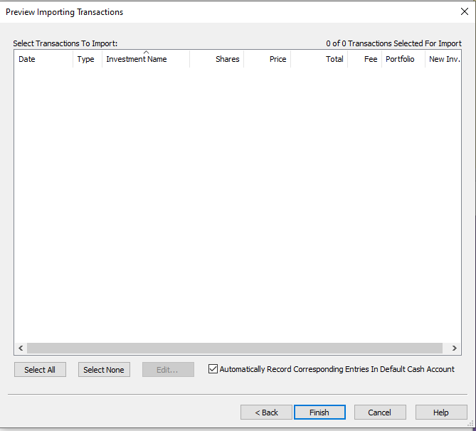

See the attached images. The "Preview importing" screen showed no data, but I'm new to FM, so maybe that's as expected.
After the retrieval - which went suspiciously quickly - I tried to find those older transactions. I enabled the View/Hidden Investments/Portfolios and can see investments in this FM portfolio with zero current value (because I sold them) from the past 90 days. I ran an investment transactions report. But nothing from the last 88 days of 2017.

If the "Preview Importing Transactions" is empty (as shown in your picture), then you didn't import any transactions. You might try a more recent date range. I'm not sure how far back you can go with Fidelity. Just because you can see transaction history on their website, doesn't mean it is available that far back on their OFX server, which is where FM is accessing your data. They can have different amounts of data available.
