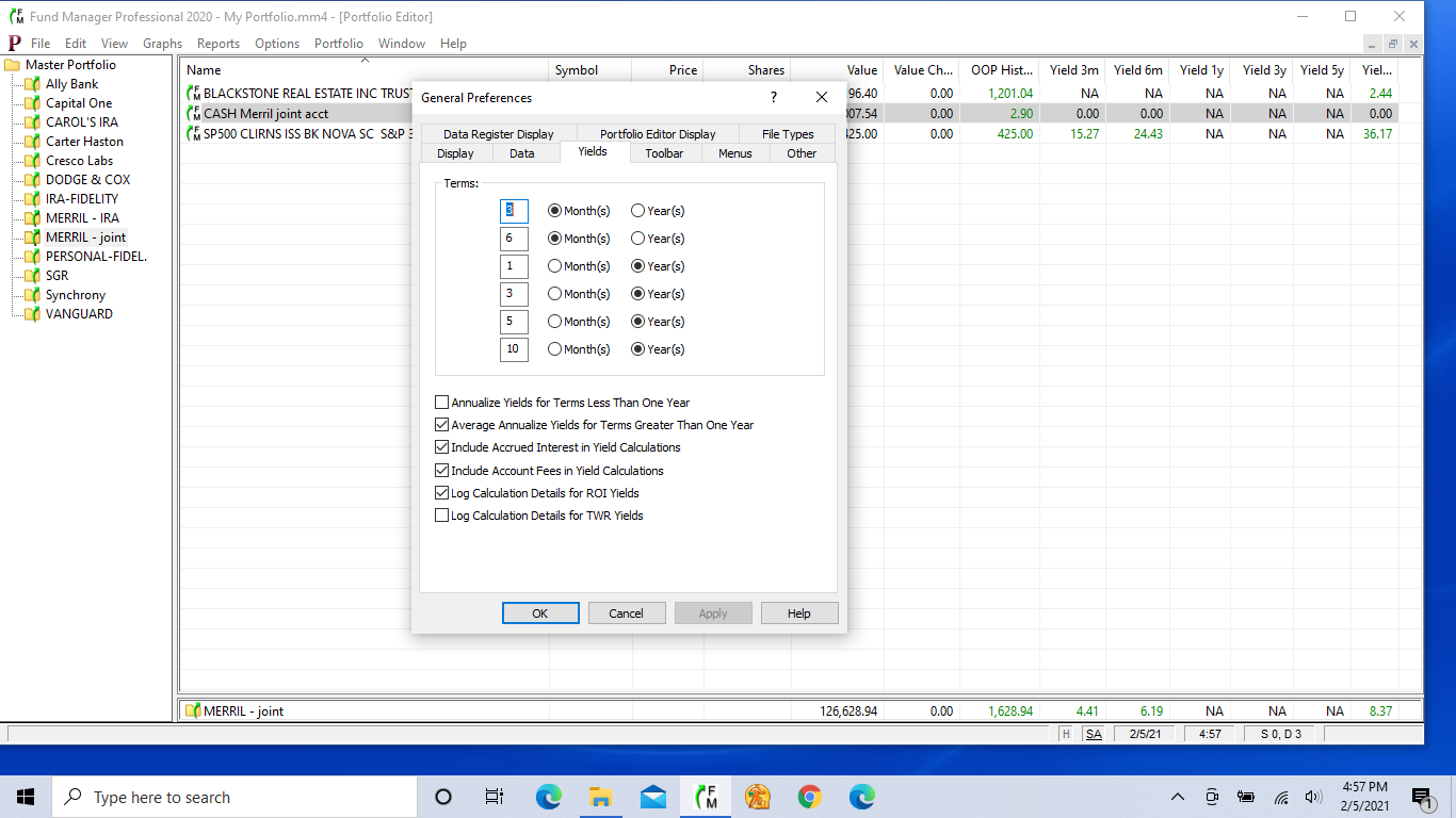

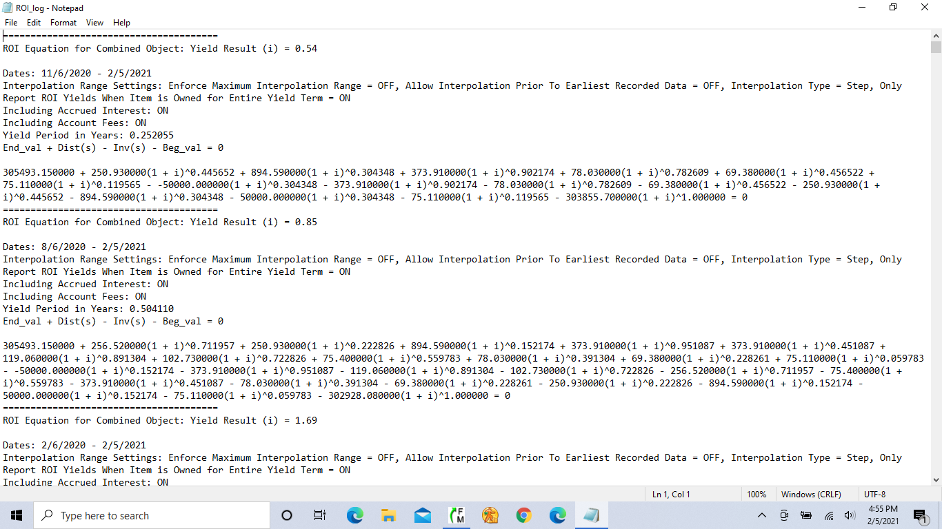

Postby alan green » Fri Feb 05, 2021 3:01 pm
see attached files. After selecting Log Calculation for ROI I closed the program.

Postby Mark » Fri Feb 05, 2021 5:11 pm
Hi alan green,
I only see a screenshot of the log file, and the part captured doesn't show the investment calculation in question. Can you see the 15.27 value in the log file? For example, from my snippet that I posted it has a line like:
Code: Select all
ROI Equation for investment "test": Yield Result (i) = 5.74
You should see one for your investment "SP500 CLIRNS ISS BK..." that has a yield result of 15.27. Please just copy/paste that segment of the log file as text into a forum post. If this doesn't make sense, maybe just give me a call...
