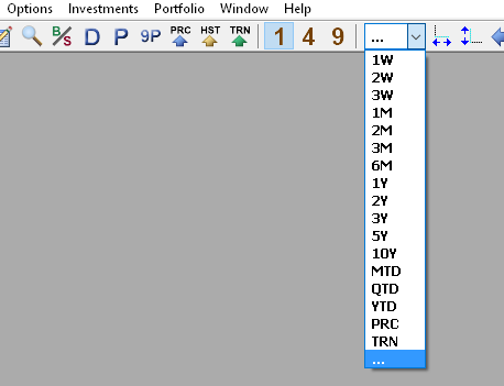

So how can I select a ten year span until the default ending date?
I use FM personal 2022.17.3.100

Postby Mark » Mon Oct 03, 2022 10:35 am
Hi Peter,
Those date ranges are for a report. Make sure you're looking at the drop-down on the toolbar, while you have a Graph window selected. It should look like:
Graph date drop-down
Postby senior » Mon Oct 03, 2022 10:33 pm
many thanks for your help. That was exactly the info I needed.
