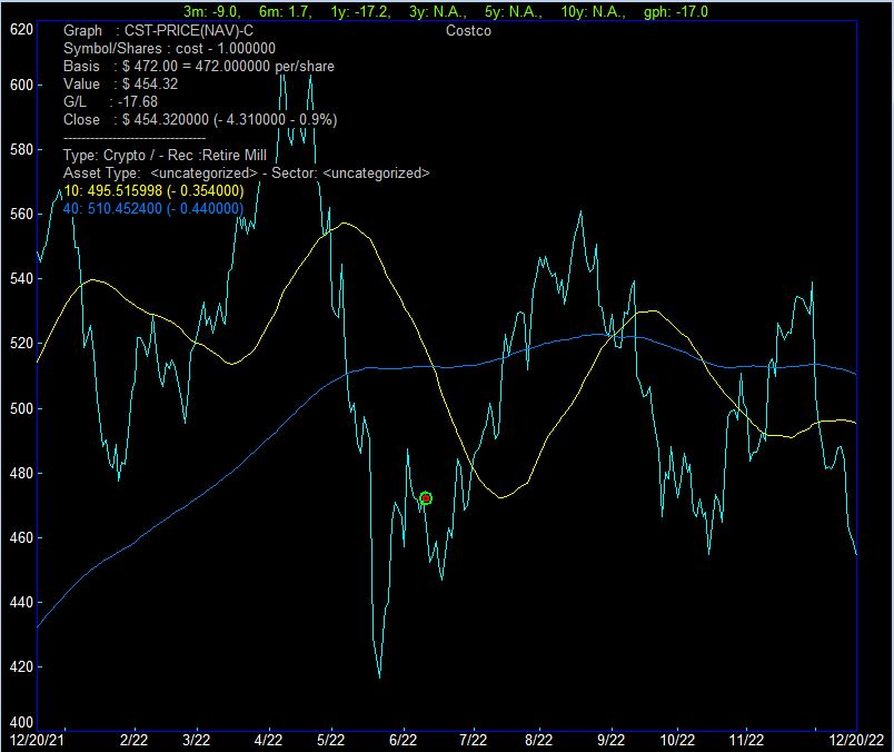

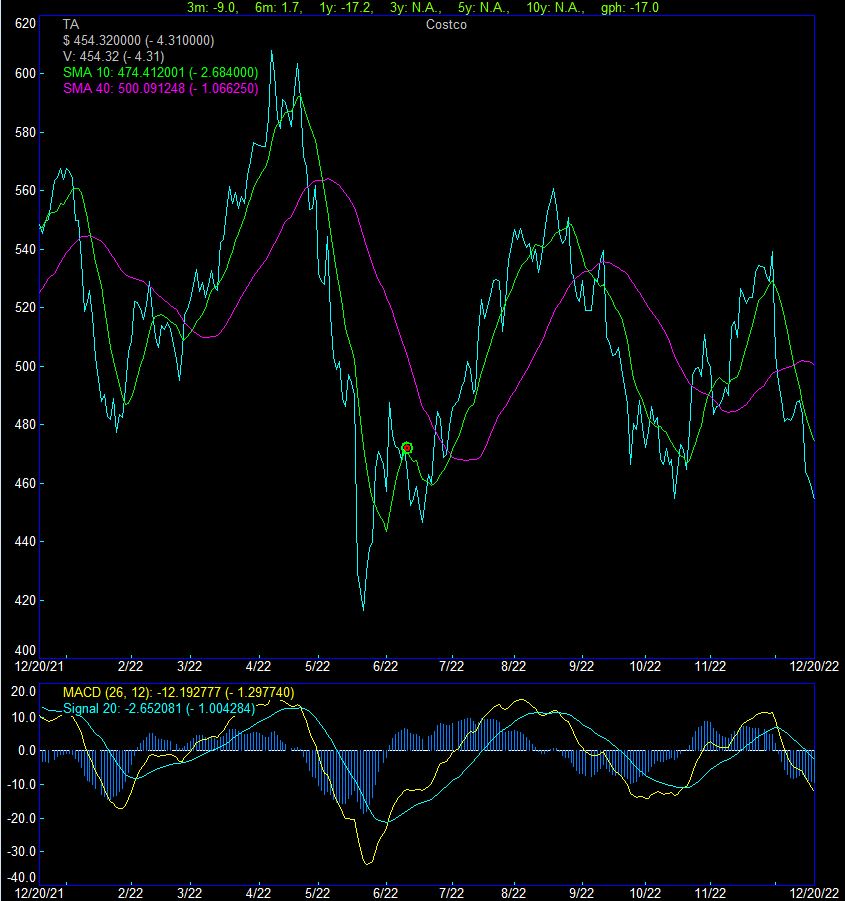

To be clear, if I want a 50 and 200 day moving average, I should divide by 5 and get 10 and 40. This is for both the MA Overlay graph and the TA Graph with MA in the upper graph?
When I do this, the 40 week MA in the MA Overlay graph does not look right. Look at these two screenshots.

Postby Mark » Tue Dec 20, 2022 2:41 pm
Hi Ilikemybu,
No. The Moving Average graphs are specified in weeks (5 periods), and the TA graph is specified in periods. So, the graphs:
Graphs / Moving Average
Graphs / MA Overlay
both use: "Graphs / Options / Moving Average Weeks..." and this specifies the moving average in weeks, which is 5 periods for each week.
The graph:
Graphs / Technical Analysis
uses: "Graphs / Options / Technical Analysis..." and the moving averages are specified in "periods". Both of these dialogs are labelled, one with Weeks, and the other with Periods.
So, if you want a 50 and 200 day moving average, set:
"Graphs / Options / Moving Average Weeks..." to 10 and 40 weeks
"Graphs / Options / Technical Analysis..." to 50 and 200 periods
