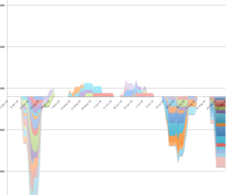

Postby Nick » Wed Aug 29, 2018 3:42 pm
Hi Mark this is the same exact data exported from FM straight into Excel spreadsheet and stacked chart-ed with no treatment of the numbers in anyway - this is kind of what i was expecting in FM. Hope this makes sense sorry if it wasn't clear before. N.

Postby Mark » Wed Aug 29, 2018 4:01 pm
Hi Nick,
If you are only long, or only short, I can see it working. However, in my example previously, the +5 segment needs to end at +3, since that is the total. If it starts at zero, then it is only +3 wide, and mis-represents the size of that object. If it starts at -2 so that the size is represented accurately, then it covers up all the short positions.
Postby Nick » Wed Aug 29, 2018 5:47 pm
Thanks Mark - doesn't the Excel spreadsheet do it in the same way with no apparent issues? Sorry I am not trying to be difficult...just trying to understand. Thanks again for your patience. Nick.

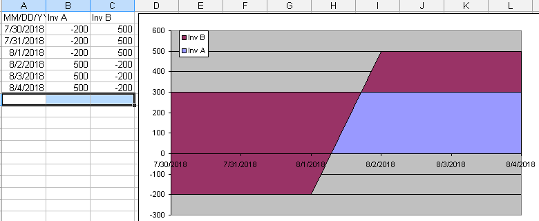

Postby Mark » Wed Aug 29, 2018 6:59 pm
Hi Nick,
It is fine, I know you're just asking. It is a valid question. I don't know what data you plotted in Excel, so it is hard to say how that is working. I put my simple example into Excel and plotted it to see how it plots this case. See this:
Excel plotting a mixture of long and short values
That sample shows the 2 cases where it plots the -200 first, or the +500 first. In all cases the total ends up at 300. If the -200 is plotted first, the +500 then covers up the short position, and ends up at +300. If the +500 is plotted first it goes up to 500 and then then -200 covers up the top portion of the +500 segment, also still ending at +300. Either way, one of the segments is at least partially covered up. Fund Manager works this same way currently.

Postby Nick » Thu Aug 30, 2018 5:15 pm
Hi Mark - I exported the date from the stack graph from RM and then opened that file in Excel and then selected the the whole spreadsheet data and clicked on stacked chart. I did not treat the data in anyway at...it was the raw data in the same format as FM gave me. I did not change any of the default settings for Excel either nor adjust the chart. Nick.
Nick
Posts: 19
Joined: Tue Aug 21, 2018 2:03 am
Postby Mark » Thu Aug 30, 2018 5:26 pm
Hi Nick,
Does the plot from FM looks different than the plot from Excel for the same data? If so, can you send me a *.FMB backup file with a sample, so I can reproduce it here?
