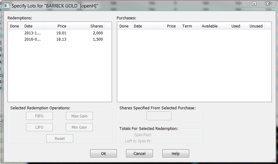

Postby ThomasK » Tue Sep 27, 2016 11:27 am
This is from Investment Data / Specify Lots for a stock price chart that shows the purchases as "specified" (ie not having the green circle around the red marker)
Specify Lot Issue.PNG (63.69 KiB) Viewed 5037 times
That makes sense.
So, most likely the few stocks that show "specified" (ie not having the green circle around the red buy marker) were bought/sold via Specified Lots or FIFO.
When I pull up Investment Data/Specify Lots for a stock that is UNspecified, no shares are listed in either Redemptions or Purchases.
How best to "unspecify" shares as in this example?
Thomas
Postby Mark » Tue Sep 27, 2016 11:57 am
Hi Thomas,
If nothing is listed in the "Redemptions" box, then you haven't sold anything, and there is no need to do anything. In that picture you've sold 2 lots, but haven't specified them, so no un-specified lot markers will be shown, since you have sold some shares, but haven't specified which shares you sold.
Postby ThomasK » Tue Sep 27, 2016 12:36 pm
Ah, so WHEN I sell something the green circle around the red buy market disappears, regardless if I don't specify anything?
Sorry for all the posts...I'm actually just putting more and more of the features to work! This is awesome software!
Postby Mark » Tue Sep 27, 2016 1:08 pm
Hi Thomas,
Yes, if you sell something and do not specify anything all the green circles will disappear. It doesn't know what lots are still available for selling since you haven't specified which shares were sold, so it won't display anything as available for selling. Use the Specify Lots dialog to specify it, and then the remaining shares will be shown as available.
