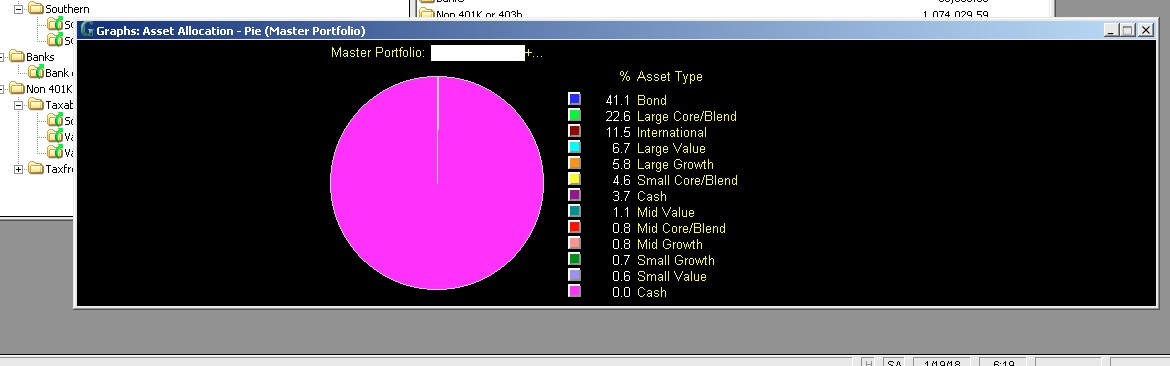

I recently updated Fundmanager to the latest version and have seen a number of strange things since updating. The latest is the pie chart for asset allocation. I've attempted to upload an image which shows the pie chart all one color which happens to be the lowest percentage asset. It only happens on a few of my portfolios. Any idea what I have done to cause this?

Looks like it might be an odd drawing artifact we haven't run into before. Would you be willing to email us a backup of your data, so we can try to reproduce it here?

I suspect it is an issue drawing the very small wedge. Instead of the small wedge somehow the graphics engine is drawing nearly a full circle. You might see if making the window bigger helps, or you could switch to using a "Stacked" graph, which is basically a pie chart versus time. Stacked graphs can be plotted with a Y axis of value, or percentage (Graph Options / Normalize).

Another idea: Lower the value of "Graphs / Options / Display... / Maximum Number of Slices in "Pie" Graphs". If you set that to 10 for that example, that should fix it. Also, I just noticed you have 2 "Cash" asset types. If you just had 1, and put all of your cash in the same asset type, that would eliminate that very small one causing the problem.

I consolidated the two "cash" asset types & changed the max number of pie slices to 12 & it appears to have resolved the issue. The really strange part is that when I went back and changed the max pie slices back to the default 100, it still worked properly.
