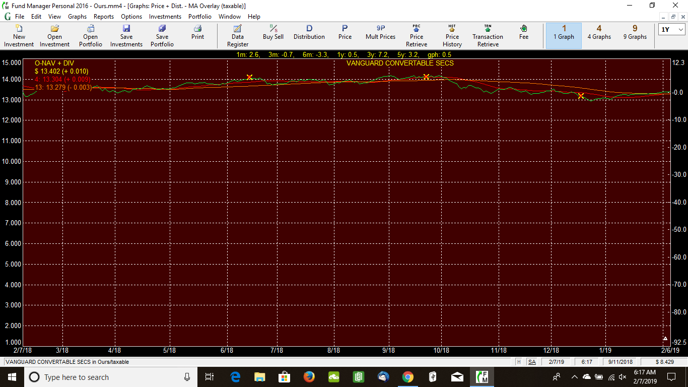

Postby raysk » Thu Feb 07, 2019 4:24 am
Screenshot (1).png (95.33 KiB) Viewed 3930 times
No matter how many times I set scale it reverts back to this.
raysk
Posts: 27
Joined: Sun Mar 16, 2008 6:27 am
Postby Mark » Thu Feb 07, 2019 9:24 am
Hi raysk,
When you autoscale, it includes any displayed markers in setting the scale. Notice you have a marker in that screen shot in the bottom/right corner. It is a sell marker, it looks like around Feb 1, 2019 for a price near 1.4. This is why autoscale is setting the minimum scale down to 1.0. That looks like an errant transaction, which you can edit to correct.
Postby raysk » Thu Feb 07, 2019 11:24 am
Thanks Mark,that did the trick. I did a manual reconciliation and forgot to put the value in.
All is well now.
