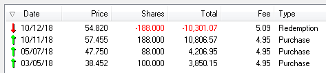

Here are the transactions in the sample you sent:
The OOP calculations use FIFO for accounting, so you sold 188 shares on 10/12/18. Those sold shares were purchased 3/5 and 5/7/18. So, the only remaining shares owned on the ending graph date were the shares purchased 10/11/18 for $10,806.57.
The transactions you typed in your original post are not the same as I'm seeing in the file you sent. For example, you showed the redemption on 3/5/18, but I see it on 10/12/18.
Postby 4Profits » Tue Sep 17, 2019 4:39 am
Thanks. That explains it.
