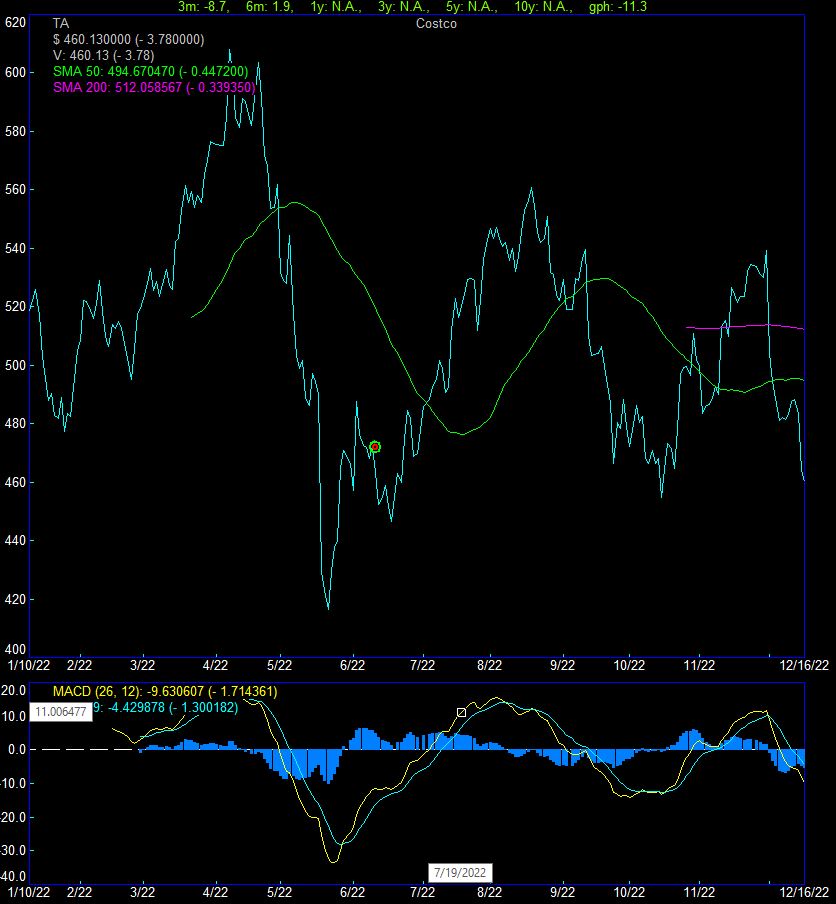

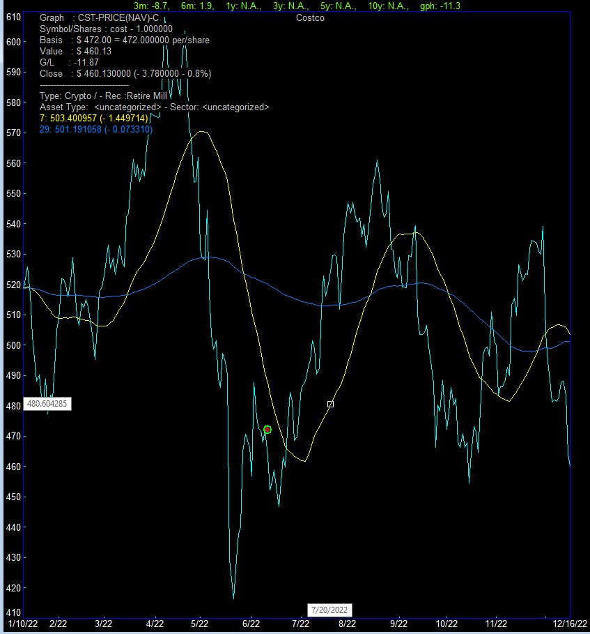

I tried matching the MA overlays (7 and 29 weeks) in the TA graph. When viewing the same investment, the curves are far different. I have set the upper gragh indicator to MA and the periods to 50 and 200 (since the TA graph uses days and the MA overlay is in weeks.
Am I missing something? Is it that one is a simple average and one is a moving average? Additionally the MA average curves in the TA graph only shows the average curves for the the last 30 days for the 200, and most but not all of the graph for the 50 day.

A "week" in the moving average graphs is 5 days, so to compare a 1 week MA in the "Moving Average" graph to the Technical Analysis "Simple Moving Average", use a period of 5 days (not 7). So, a 7 and 29 week MA would compare to 35 and 145 period SMA in the TA graph (7 * 5 = 35 and 29 * 5 = 145).
There is also a slight difference between the MA and TA-SMA plots in that the MA will interpolate a price for each weekday, even when you don't have one recorded for that particular weekday. The TA-SMA will only use weekdays with a recorded price, and skips over any day without a price, or a weekend. So, you will get some differences between the 2 when you have weekdays without recorded prices. We'll have to think about making them both work the same way when it comes to missing weekday prices, but as of now, they do work slightly differently in this case.
There is another difference between these 2 graphs in terms of how they handle prices before your first recorded price. The MA graph will interpolate back, using the first recorded price. The TA-SMA will not plot a SMA unless you have the full "Period" data points recorded. Again, we will look at making these consistent...

I agree with 4MoreProfits, by your response it seems that I should use 10 and 40 for the typical 50 and 200 day MA, I also had always thought it was a 7 day week, so 7 and 29.
Also, despite retrieving historical quotes, I still get missing graph curves as shown in the top chart for Costco in my earlier message.

Thanks, I got your email. In order for a SMA line to start plotting, you need X periods of data prior to the first plotted point, where X is the value you've entered for the number of periods to use for the simple moving average. So, your SMA 145 line isn't starting to plot until 8/8/22 because your first recorded price point is 1/10/22. For a simpler example, assume you plotted a SMA 5. Since your price data points (from the beginning) are:
1/10
1/11
1/12
1/13
1/14
The first plotted point would be 1/14. It can't plot on 1/13 because there aren't 5 data points on/before 1/13 to average yet.
