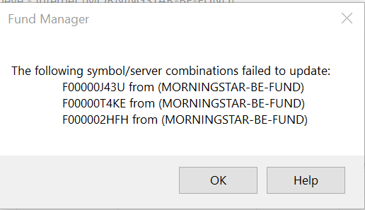

For a few days now the symbol/server combinations failed to update for three funds (see attachment) via the Morningstar BE site.
I did some investigation and noticed that the three funds display two quotes: 'bid' and 'offer'.
The other funds in the portfolio still show one quote and they are updated as in the past.
How can I solve this issue?
Regards
Alan
Fund Manager - Pop-up window
Aantekening 2020-07-09 082242.png (13.25 KiB) Viewed 1846 times

Postby Mark » Thu Jul 09, 2020 6:09 am
Hi Alan,
Yes, I see the same issue. The site isn't showing a "price" for these for some reason. We could take an average of the bid/ask, but it would be best if they offered a last price. It sounds like this is a recent change. Without the last price being available there isn't much we can do. Is it possible to find these quotes on a different server? Maybe Morningstar will correct this in the near future, but we don't have an insight into this.

Postby VFP9Belgium » Thu Jul 09, 2020 10:17 pm
Hi Mark
An average of bid/ask will not do. I followed your suggestion and changed the price source for these funds to 'Morningstar Funds'. That works :D

Postby VFP9Belgium » Tue Jul 14, 2020 11:10 pm
To whom it concerns.
In my Fri Jul 10 reply I was to hasty; it appears that Morning Funds is not the solution.
After some trial and error I found that the Financial Times provides also pricing for these funds.
That works fine.
