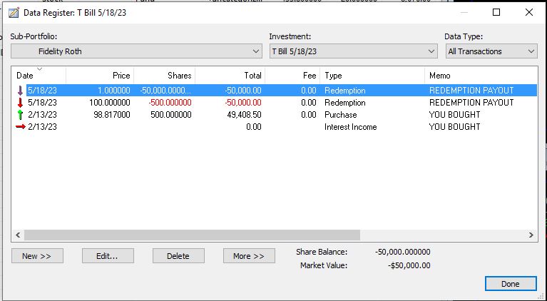

It seems I always have problems with T Bills and Bonds when they mature. When I download transactions the amounts never agree that would zero out the item. Attached is a recent example for a Tbill.

How are you downloading transactions? Are you retrieving from a broker? It looks like you have 1 extra transaction. Instead of just a redemption for 500 shares, you also have an additional redemption for 50,000 shares. If you're retrieving, can you email me the log of your transaction retrieve, and I'll take a look. Please email me both the "Raw" and "Parsed" versions under "Help / Logs / Transaction Retrieve".

Code: Select all
It turns out the broker is reporting the purchase as a BUYDEBT, but the sell is a SELLOTHER instead of a SELLDEBT, thus the current 100x difference in shares.  However, in both buy/sell cases, the security is classified under a DEBTINFO in the security list (and not an OTHERINFO), so I think we can handle this better than we are currently.
For now, I'd suggest editing the redemption to be 500 shares instead of 50,000. Keep the value the same, so the price will go from 1.0 to 100.0. It looks like you've done this once, and then maybe retrieved again, so in your case, just delete the redemption of 50,000 shares. We'll have this improved for the next major update, so you won't have to make manual corrections.

Postby alan green » Mon Feb 12, 2024 1:35 pm
I'm having the same issue with FM recording the share and price incorrectly. The purchase price records the correct price and shares and the sale is different. I'm wondering if you were able to fix this issue?

Postby Mark » Mon Feb 12, 2024 1:53 pm
Hi Alan,
Yes, we addressed this issue in version 2024.18.0. If you're using the latest version (2024.18.1) and still see an issue, please let me know.
