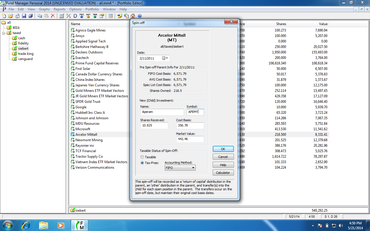

I'm getting the following error when using the spin-off wizard: Tax free spinoff not supported when any lot has a negative tax basis. The data I'm putting in are
Parent company - Arcelor Mittal
Spinoff Aperam APEMY
Date: 2/01/11
Number of shares 10.925
Cost basis 356.78 (what the brokerage showed)
Market value 442.46 (based on an open price of $40.50 on first day of trading).
Should I be entering in something different for the market value, or is there something else I'm doing wrong?

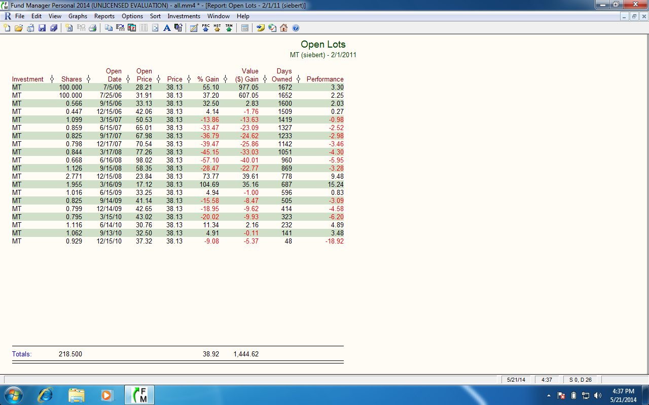

Yes, it shows $6571.79, which is different than the brokerage is showing. Is there a way to show Fund Manager's cost basis per lot? I think it may have something to do with a specific (dividend) lot. And/or the way I was recording dividends, since I wasn't sure how to account for foreign tax paid. For example, the brokerage would show a dividend received of $40.79, but would take out $6.12 as foreign tax, resulting in a cost basis of $34.67. Half of the dividends I would account for the foreign tax paid in the commission field, and half of them I didn't. So I think I need to go through each dividend transaction and straighten them out before I spend any more of your time. Attached is a screen shot of the open lots report, and the spinoff wizard.

Postby Mark » Wed May 21, 2014 3:31 pm
Hi Oscar,
While you're viewing the Open Lots report, go to "Options / Report Preferences... / Open Lots" and turn on "Tax Basis". Make sure you're running the open lots report with the same accounting method as you're using in the spin-off wizard. If that doesn't help identify the problem, you can email us that investment file, and we can take a look.
