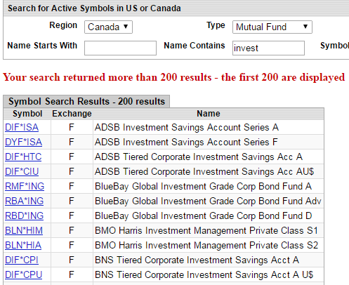

Postby Djobydjoba » Sun Nov 26, 2017 7:58 am
You can search with the mutual fund name, or a part of it, in the fields at the top of the page, and the symbol is returned:
Have you tried?
Posts: 846
Postby Ron AKA » Sun Nov 26, 2017 11:29 am
Djobydjoba wrote:You can search with the mutual fund name, or a part of it, in the fields at the top of the page, and the symbol is returned:
Have you tried?
Thank you. I hadn't found that search, and it does work. I found the symbols of interest with a bit of hunting around. However, one international fund I have, RBF559 (RIT*IRI) has the same issue as the Google current price database. It is one day out of date. So, I guess I will stay with Morningstar.ca for the current prices. As I said before, the prefect solution seems elusive! But, thanks for the help though.
