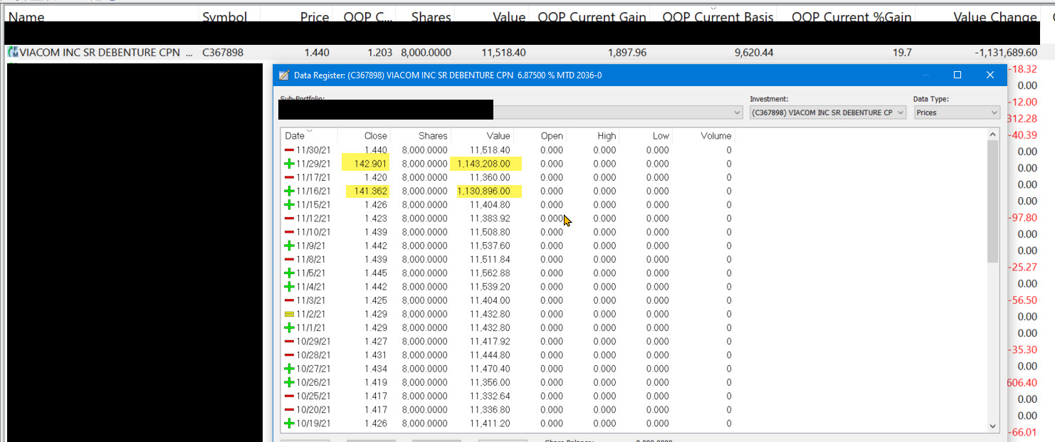

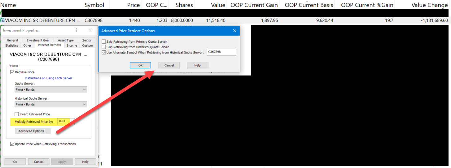

I have two bonds that I inherited and periodically the prices update incorrectly. They are both 1/100th shares but sometimes they update without respecting the Internet Retrieve setting on the investment properties which should multiply the retrieved price by "0.01". Both bonds do this periodically but I can't figure out what's wrong or a pattern to it. For example, I just retrieved historical from 11/16/21-11/30/21 and two of the prices are wrong and two are correct. Any ideas what the problem might be? I have screen shots if that might help. Thanks in advance.

Attaching files/logs. It seems like the log has been overwritten by subsequent retrievals. Note: this has happened multiple times in the past. Finra does seem to retrieve historical prices, I have never manually entered a price for these two bonds in question but I have had to correct the prices by editing the pricing data and simply moving the decimal two spaces left (to get the 1/100th price). Let me know what else you need.
showing properties
Investment Properties 1.jpg (121.64 KiB) Viewed 1949 times
showing incorrect prices
Incorrect price retrieve.jpg (190.04 KiB) Viewed 1949 times
