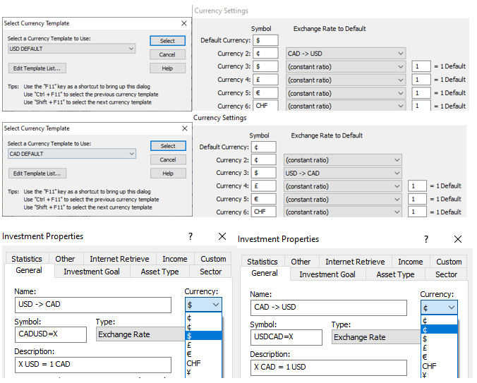

I'm having what I think are unexpected results toggling between CAD and USD via (a) Currency Settings/Default template and also (b) view data in default currency units. I'm thinking it is entirely on how I am using the "Specify Exchange Rate to Default" but could be on what Currency is set to default when I enter New Investments or view reports. It could also be the egregious FX charges above spot that is showing up.
Background:
I'm in Canada; I have all of my accounts (Margin, RRSP, TFSA) set up for both separate CAD and USD sub-accounts BUT my broker does not offer a USD sub-account for my daughter's RESP so I have to enter BOTH CAD and USD investments into the RESP portfolio which has a CAD Default Cash Account.
Questions:
1. When creating a New Investment, beyond selecting the correct currency with the pull-down, is it important as what Currency Default needs to be set?
2. When adding to positions Buys/Sells what is the correct use of the "Specify Exchange Rate to Default", i.e. when to check the box and when not to?
Thomas
Just to show, for setup, I've reviewed previous board posts, Help and the Tutorial. I've been observant of:
- maintaining the order of Currency 2, 3, 4, 5, etc between Currency Templates
- careful of using the Currency pull-down menu to select the ¢ or $ for New Investment
(note I use "Alt+0162" for the ¢ sign for CAD but use the keyboard "$" for USD
- double checked that all was correct...see image below
FM - Multiple Currencies Setup.png (131.2 KiB) Viewed 1401 times

Postby ThomasK » Sun Dec 19, 2021 4:41 pm
Thanks Mark,
Okay, now I got it. I did have to play with it a bit (New Investment vs adding/subtracting from the investment vs double-clicking on the line item in Data Manager). Indeed, FM handles all the switching between multiple currencies (eg CAD - USD) seamlessly. My confusion was from two points: (a) the huge surcharge on FX by my broker and (b) my sloppiness creating the New Investment.
