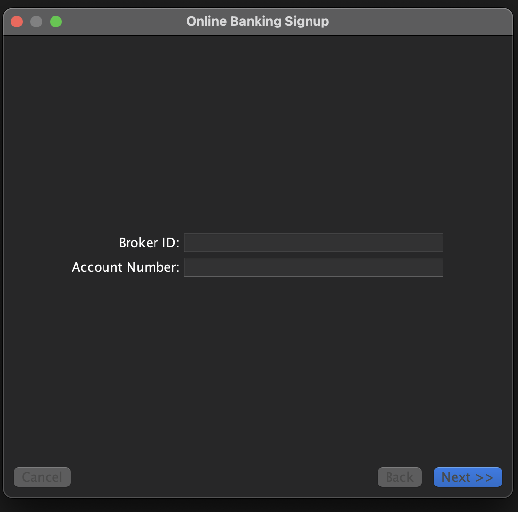

Postby jccccj33 » Fri May 16, 2025 4:13 pm
Motivated by my TIAA success with Moneydance (I use and want to use FM) I tried downloading Vanguard transactions. No real joy. After a long wait while Moneydance tried to find Vanguard's profile I got the attached. Sent on the unlikely chance it can help restore access from FM.
Jose
Screenshot 2025-05-16 at 7.07.13 PM.png (79.43 KiB) Viewed 2754 times

Postby Mark » Sat May 17, 2025 1:36 am
Hi Jose,
Thanks for the help. That is a good data point on Moneydance. I’ll investigate more and post back here when I know more.
