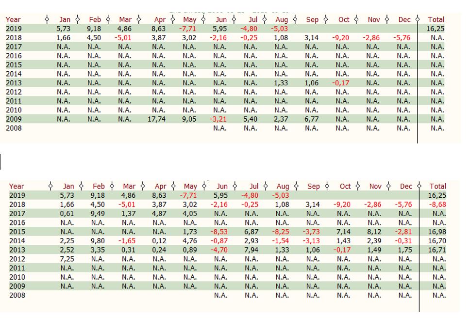

The calculations in my Monthly Perfromance Report are not consistent. For some months the TWR-return is displayed and for other months N.A. is shown.
Just by opening the Settings dialog and closing it again, not changing any setting, the report is recalculated but now different months are showing either TWR-return or N.A..
I've attached an image of two reports that should be identical, the only difference between them is that I recalculated as mentioned above.
I'm using Fund Manager Personal Version 2020.16.0.100
Screen shot Monthly Performance Report
Bugg monthly report.JPG (135.16 KiB) Viewed 4714 times

Is this problem reproducible? If you look at "Help / Logs / Report Calculation..." what are the reasons being given for the NA values? Are the reasons correct?
Postby mahe79 » Fri Oct 18, 2019 11:07 am
Yes, it is reproducible. It happens every time I open the report. Sometimes all but a few months are calculated, the next time almost none are calculated.
The Report Calculation Log shows:
"Unable to calculate TWR for dates 10/1/2008 - 10/31/2008. (Failed to open log file)"
for each month that is shown as N.A.
If I change settings "Log Calculation Details for TWR Yields" to OFF the Monthly Performance Report is shown correctly. The problem is only occurring for TWR. The other performance metrics ROI, Gain, Value are calculated without a problem.

I forgot to mention that the TWR log contains only the correctly calculated months. So Fund Manager is capable of opening the log file, but not for the entire report date settings.
