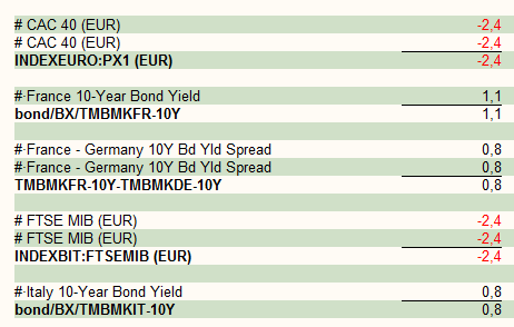

Postby Djobydjoba » Sat Mar 03, 2018 8:25 am
My reports have a subtotal by Asset Type already, so I can't subtotal by Symbol at the same time.
Moreover, I really don't like the output when subtotaling by symbol:
I find it is worst than having the same investment repeated several times. Because:
- the additional lines subtotal with the symbol added for each investment make the report mega heavy, hard to read. Unworkable from my point of view.
- the duplicate investments are still displayed
- the symbols are meaningless for me, so I don't want to see them in reports
I guess this a quite related to the topic here: viewtopic.php?f=7&t=4658 At the end of the topic you wrote "The symbol is useful to group multiple investments together for reports/graphs."
I understand this is a technical design, but, again, symbols are quite meaningless, there are essentially codes to download prices. There should be a mechanism to group the same investments while displaying by names, and not by symbols. This is equally true for the pie charts.
Considering the current technical design, an option to hide copies in the same sub-total could be useful. Because we are really talking of copies here, duplicates, that share the same investment file.
Anyway, to avoid the duplicate in reports there is always the option to rearrange the portfolio tree. What I've just did. But, to summarize the feedback, it would be great if there could be a mechanism to group the same investments while displaying by names, and not by symbols.
Why not simply group investments when they share exactly the same name (and currency), instead of the same symbol? Couldn't it be an option?

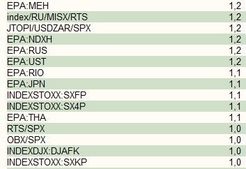

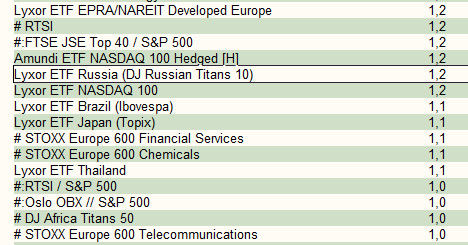

Postby Djobydjoba » Mon Mar 05, 2018 9:22 am
I've re-organized my sub-portfolio tree in order to avoid duplicates.
Sorry to be insistent on that, but here's an extract of a report listed by investment:
an the same report listed by symbol:
Isn't it unworkable by symbol?
Currently, when we want to merge same investments, when have to display them by symbol.
Don't you think there should be the ability (option) to merge same investments independently of the display (by name or by symbol)?

Postby Mark » Mon Mar 05, 2018 9:47 am
Try changing the report setting:
Options / Report Preferences... / General / Symbol Lines Labeled As:
to "Investment Description", and I believe you'll get what you're looking for. In this case, the lines will be labelled as your preference is set under "Options / General Preferences... / Display / Investment Description".
