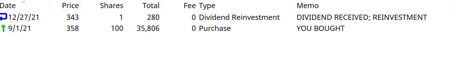

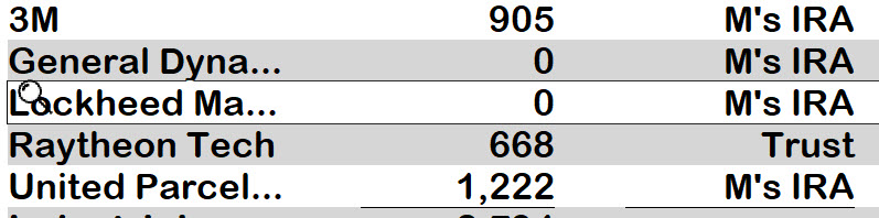

Postby Mary Kennedy » Sat Mar 05, 2022 9:49 am
FM div report 2022-03-05_11-39-42.jpg (64.78 KiB) Viewed 2813 times
LMT data register 2022-03-05.jpg (83.46 KiB) Viewed 2813 times
The variable I am using is called Dist dist-C (end) I am attaching a section of my report showing zero divs for LMT. Also attached is the data register for LMt

Postby Mark » Sat Mar 05, 2022 10:54 am
Hi Mary Kennedy,
I can't see the headers or the date. Are you sure you're looking at the right investment? Is the report's ending date after your distribution?
