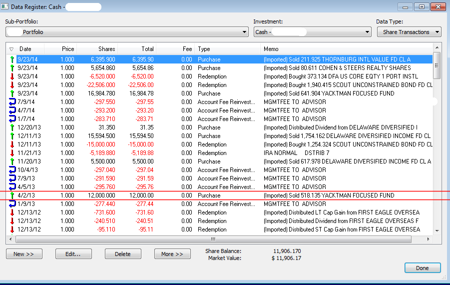

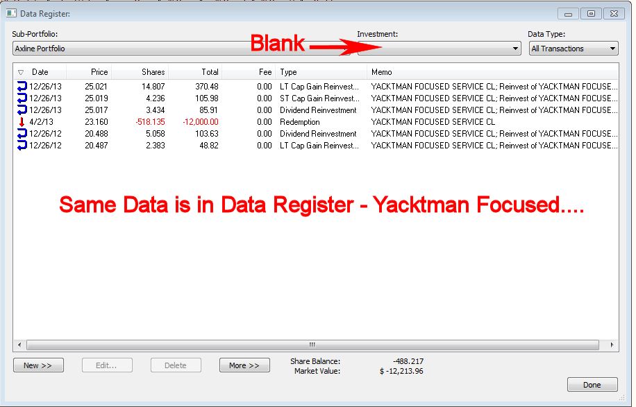

We have been trying to trace discrepancies between our Investment Manager Account and our Fund Manger data. We have found that a group of transactions have been loading into the proper Fund Manager Investment, as well as, into a "Blank" investment at the top of the Investment List. This has created an imbalance in 3 items in the list. The BLANK investment, the Yacktman Investment, and the Cash account. (See Attached items.)
FM Data Reg for Blank Investment.PNG (27.08 KiB) Viewed 2716 times

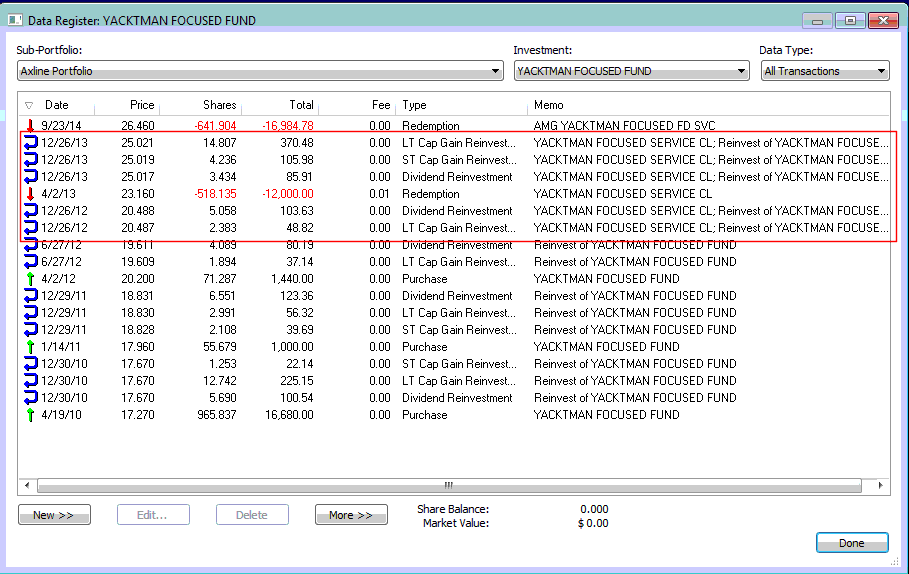

This is a view of the Data File for Yacktman Focus Investment. Note the duplicate entry. (Same as "blank" data register.) All of these transactions were generated by the "Retrieve Transaction" function.
Tried to delete the "Blank" Investment activity. Will come back across with the next "Retrieve Transactions".

You are right. There was a change in the cusip on the transaction in question (4/2/13). Not certain why. As you can see, the identical info was applied to both the Yacktman and the Blank Investments.
There was a more recent transaction on this account (9/23/14) with the same Yacktman Investment. The name of the Investment was changed and the cusip is another new number (different from the original and the change on 4/2/13). Is the cusip used in the transfer to the appropriate account? If so, how did the newest data go to the proper account?
How do I get rid of the info in the blank Investment. I can't shift the activity to the current Yacktman Investment, it is already there. A retrieval will simply bring it back in, if I simply delete the Blank Investment.

I am able to correct the imbalance in the sub-portfolio that we discussed, however, the only way to prevent the transactions in the blank investment from returning, is to limit the retrieval date. I'm still not certain how the exact same transactions can be in the proper investment and duplicated in the Blank Investment.
