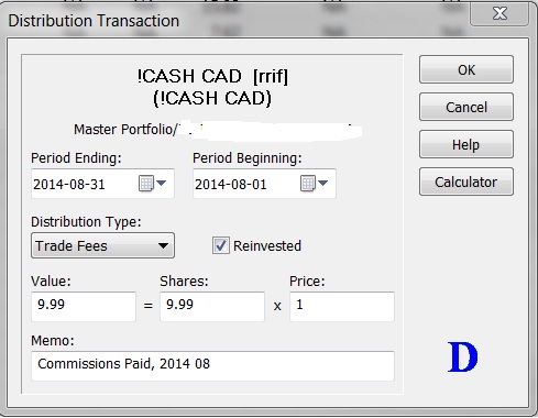

Postby ThomasK » Fri Feb 26, 2016 12:31 pm
In reviewing how I'm using Fund Manager I think I noticed an error that would indeed be throwing out my cash balances!
Background: I wish to track individual investments without commissions in but at the end of the month account for all the commissions I paid in one lump sum so that my cash balance in FM jives with the cash balance on my brokerage statement.
Solution:
a. I have all investments Transaction Entry Preferences in properties set to "No Fees"
b. At the end of the month I create 1 entry to show the commissions paid as a Distribution Transaction.
Question: Please see the attached example
I made 1 trade for a $9.99 commission that month. I input the Period beginning/ending dates, values, shares, BUT THE PRICE SHOULD HAVE BEEN NEGATIVE 1, YES?
Thanks...I sometimes get an incorrect concept in my head and can't seem to shake it out.
This should be entered with a "-1" for the price?
Incorrect way to record commissions.jpg (50.87 KiB) Viewed 2208 times
Postby Mark » Fri Feb 26, 2016 6:33 pm
Hi ThomasK,
To record something like this you should record the value/shares as negative and leave the price at 1. The price for all cash transactions should always be 1. Since you have a negative number of shares, it will reduce the number of shares of cash you have, decreasing your balance.
