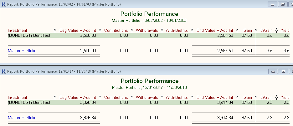

Thanks for the details. I was able to reproduce your case here. The interest that you're accruing is based off the initial purchase of $2,500, which is different from the starting value in all the yield terms, except the first year. If you look at the very first year, you will see you earn the 3.5% rate, as it is based off the $2,500, before you accrued interest. However, if you look at later years (as you've done in your example from 12/1/17-11/30/18), you are still earning the same amount of interest in a year ($87.50 = 3.5% * $2,500), but it is a relatively smaller percentage compared to the total value with accrued interest up to that beginning point.
First year: $87.50/$2,500 = 3.5%
~2018 year: $87.50/$3,826.84 = 2.3%
Another way to think of it is that you're not getting 3.5% on your accrued interest (it isn't compounding). When you haven't accrued any interest, you're earning the full 3.5%, but once you've accrued interest you're earning a lower rate considering the accrued value. If you look at the yield log file, you will see equations for the first year versus the last year, like this:

Reports for first and current years
