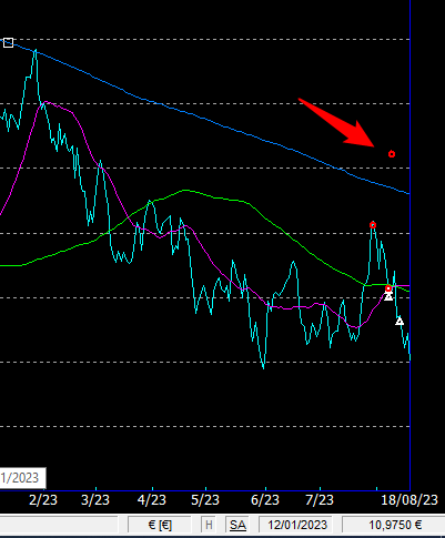

Sometimes I forget that the USD template is loaded and it may happen that I enter new transactions with this wrong template. I've just noticed the problem thanks to a misplaced buy marker in an investment graph:
NB: the investment is in EUR (not default) currency.

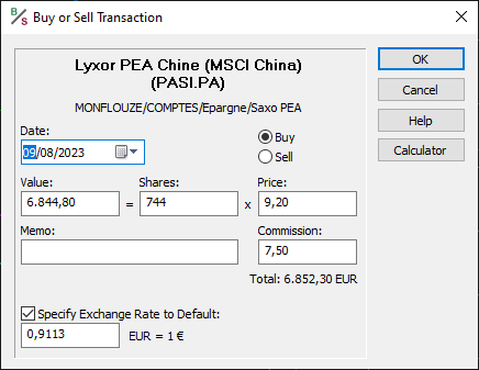

Opening the transaction, the Specific Exchange Rate is wrong. I have to fix it to 1 EUR = 1 €.

One item to note is when you're recording this transaction, if your currency template is set to USD, you should see the label on this option display as: X EUR = 1 USD instead of X EUR = 1 €.
Another point is that this option is defaulted to whether or not you used it last time. So, if the last time you recorded a buy, you leave the "Specify Exchange Rate to Default" un-checked, the next time it will initialize to un-checked. It isn't always activated by default, it is initialized based on whether you used it or not last time you added/edited a transaction.
