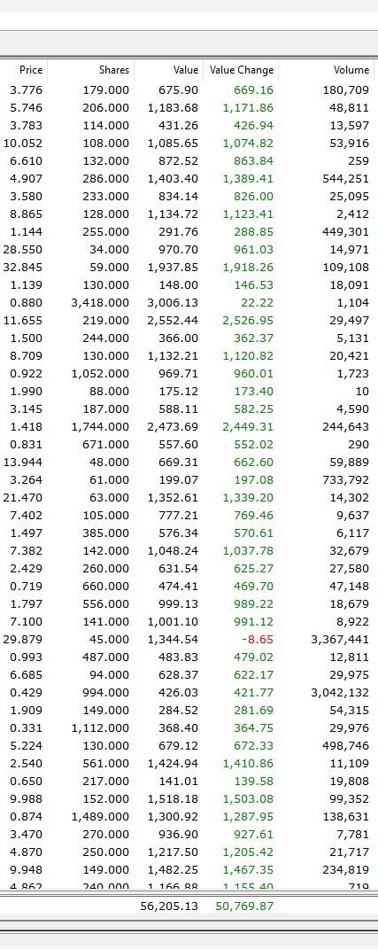

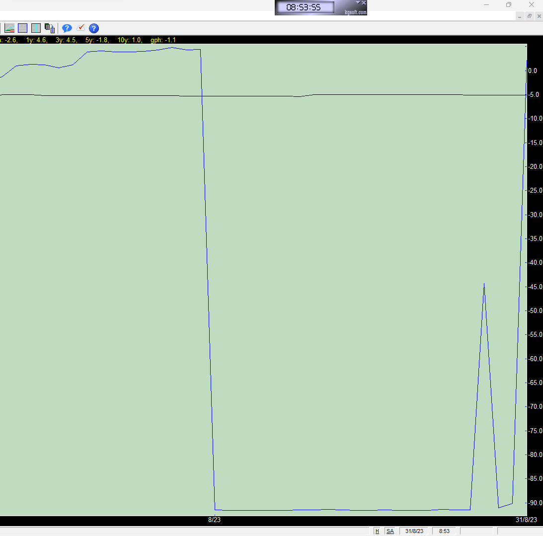

Just updated Historical prices from 1st to 31st August with disastrous results, see screenshots, How do I get out of this? Do I need to use backups for every .dat file (I hope not!)
Screenshot 2023-08-31 085511.png (58.92 KiB) Viewed 2160 times
Screenshot 2023-08-31 085420.png (27.33 KiB) Viewed 2160 times

Can you give me an example ticker symbol that is retrieving the wrong pricing from Yahoo (Historical)? I don't see a problem when testing with some samples from here. Also, what quote module are you using? See "Help / About...". The latest is 586.
To fix any wrong data, you can either quit without saving or restore from a recent backup.
1) Quit without saving: Make sure the options to save on exit under the "Options" menu are un-checked, and exit FM, saying No, when asked to save.
2) Restore: FM makes automatic backups, and you can restore from one of these using "File / Restore...". With a single restore, you can restore everything. See "Options / General Preferences... / Data" for the location/frequency of your automatic backups.
Postby progers1947 » Thu Aug 31, 2023 3:19 pm
Hi Mark
All the tickers were giving the wrong prices, e.g.AV.L, BA.L, BAB.L to nane a few
It was tonight I realise all the back up files were 2021, there were 30 of them, should they not be overwritten, oldest first?
So I'm restoring all my current share prices from NAS backups, one at a time!

I think I may know what has caused the problem. As of quote module 585 we applied the divide by 100 scaling for all symbols ending in .L to the Yahoo (Historical) server. This was done in an attempt to help Yahoo users in Europe when the daily Yahoo servers weren't working, and to make it consistent with the Yahoo - UK & Ireland server. This update happened in early August, and it sounds like you're only updating once a month, so this might be the first time you've run into this. Are you tracking your prices in pence or pounds? By default now, .L investments will be updated in pounds. If you want them in pence you'll have to make a registry edit or modify your investment's retrieve properties. Please see the instructions here:
https://www.fundmanagersoftware.com/intrtv.html#YahooUK
where you go in and set the registry value of "yahoo_uk" to 1. Or, you can set the "Investment Properties... / Internet Retrieve / Multiple Retrieved Price" to 100.
